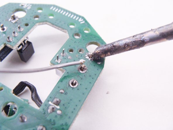

    5. Logitech M720 Micro-switch Replacement, Desoldering micro-switches: crwdns2935265:06crwdnd2935265:01crwdnd2935265:03crwdne2935265:0 Logitech M720 Micro-switch Replacement, Desoldering micro-switches: crwdns2935265:06crwdnd2935265:02crwdnd2935265:03crwdne2935265:0 Logitech M720 Micro-switch Replacement, Desoldering micro-switches: crwdns2935265:06crwdnd2935265:03crwdnd2935265:03crwdne2935265:0
      Desoldering Pump
      $3.99
      • Identify and de-solder the micro-switch solder pads using your preferred de-soldering method, such as a solder pump or de-soldering wick. Your soldering iron tip should be clean and properly tinned, unlike my atrocious tip pictured here
      • If required, pry the old switches off with a flat-blade screwdriver while applying heat to the solder pads
    6. Logitech M720 Micro-switch Replacement, Switch replacement: crwdns2935265:07crwdnd2935265:01crwdnd2935265:03crwdne2935265:0 Logitech M720 Micro-switch Replacement, Switch replacement: crwdns2935265:07crwdnd2935265:02crwdnd2935265:03crwdne2935265:0 Logitech M720 Micro-switch Replacement, Switch replacement: crwdns2935265:07crwdnd2935265:03crwdnd2935265:03crwdne2935265:0
      • Install and solder the new switches
      • Again, be sure to use a correctly tinned and clean soldering iron tip. Your tip should not be as gnarly as mine is in these pictures
