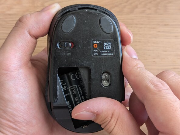

    • Caution: Before you begin, ensure that the mouse is powered off (red color displayed on the switch). The switch can be found at the bottom of the mouse.
    • Remove the battery cover from the bottom of the mouse by sliding downwards.

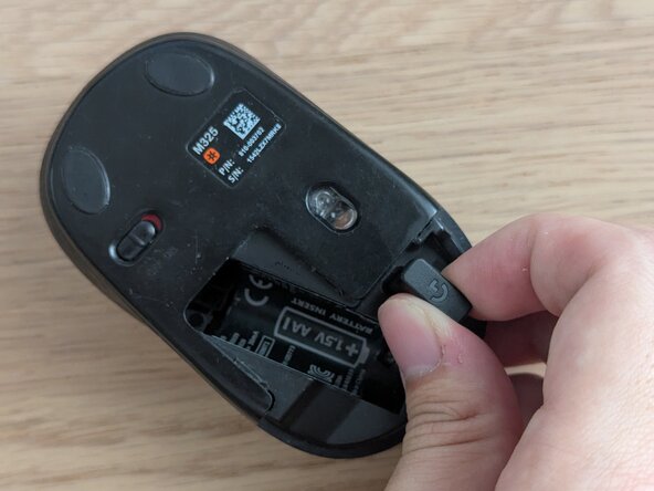

    • Lift out the AA battery.
    • Remove the USB adapter.

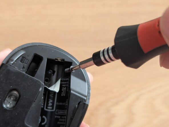

    • Peel off the sticker in the battery compartment to reveal the screw underneath.
  4. Logitech M325 Scroll Wheel Replacement: crwdns2935265:04crwdnd2935265:01crwdnd2935265:02crwdne2935265:0 Logitech M325 Scroll Wheel Replacement: crwdns2935265:04crwdnd2935265:02crwdnd2935265:02crwdne2935265:0
    • Use a Phillips #0 screwdriver to remove the 5 mm screw in the battery compartment.

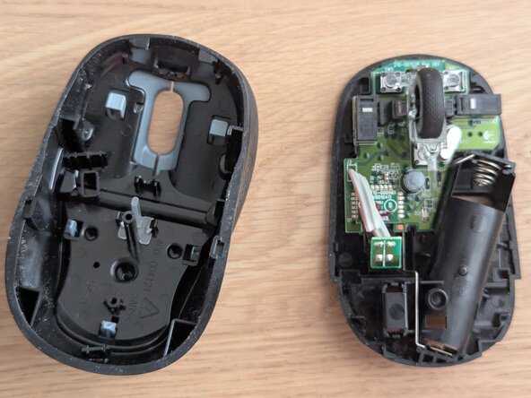

    • Slide the lower case downwards and separate the top case from the main mouse body by lifting it off.

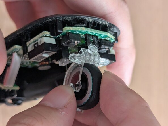

    • Use a pry tool to unclip the scroll wheel from the PCB by pushing the clip out of the holder.
    • Remove the scroll wheel by lifting it up.

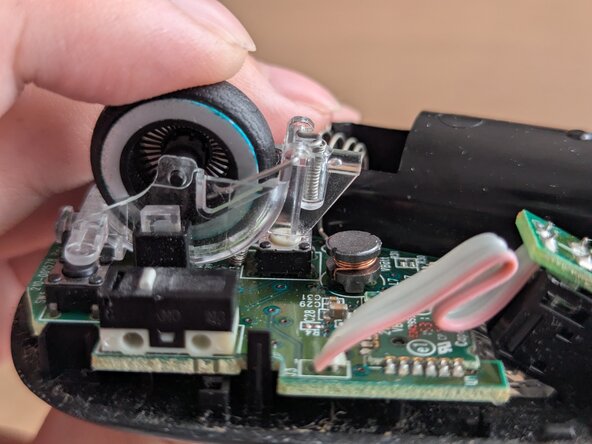

  7. Logitech M325 Scroll Wheel Replacement: crwdns2935265:07crwdnd2935265:01crwdnd2935265:02crwdne2935265:0 Logitech M325 Scroll Wheel Replacement: crwdns2935265:07crwdnd2935265:02crwdnd2935265:02crwdne2935265:0
    • Align the replacement in the same position as the old scroll wheel.
    • Push down and clip in the scroll wheel.
