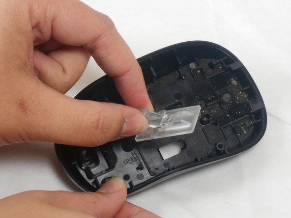

    1. Logitech M215 Lens Replacement, Lens: crwdns2935265:06crwdnd2935265:01crwdnd2935265:02crwdne2935265:0 Logitech M215 Lens Replacement, Lens: crwdns2935265:06crwdnd2935265:02crwdnd2935265:02crwdne2935265:0
      • The laser amplifier is not connected to the rest of the mouse and can simply be removed at this point.
