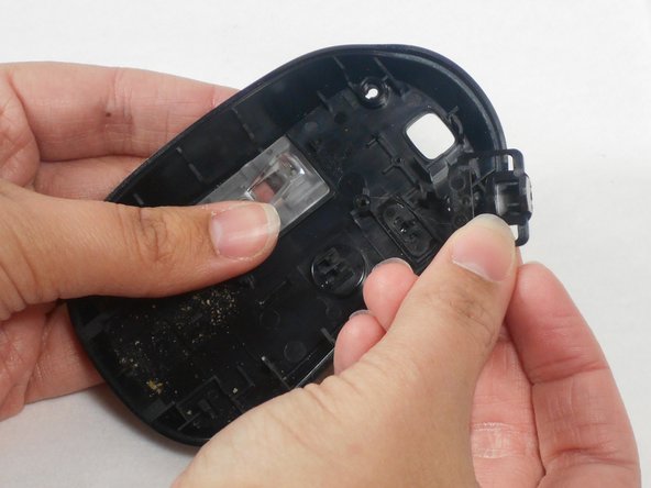

  4. Logitech M215 Cover Release Button Replacement: crwdns2935265:04crwdnd2935265:01crwdnd2935265:01crwdne2935265:0
    • Pry the top cover off. You may need to use a pry tool to help.
  5. Logitech M215 Cover Release Button Replacement, Motherboard: crwdns2935265:05crwdnd2935265:01crwdnd2935265:02crwdne2935265:0 Logitech M215 Cover Release Button Replacement, Motherboard: crwdns2935265:05crwdnd2935265:02crwdnd2935265:02crwdne2935265:0
    • Unscrew the 0.25mm phillips head screw to release the circuit board.
  6. Logitech M215 Cover Release Button Replacement, Cover Release Button: crwdns2935265:06crwdnd2935265:01crwdnd2935265:03crwdne2935265:0 Logitech M215 Cover Release Button Replacement, Cover Release Button: crwdns2935265:06crwdnd2935265:02crwdnd2935265:03crwdne2935265:0 Logitech M215 Cover Release Button Replacement, Cover Release Button: crwdns2935265:06crwdnd2935265:03crwdnd2935265:03crwdne2935265:0
    • Unscrew the 0.25mm phillips head screw holding the button in place. The cover release button can then be removed.
