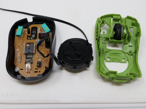

      • To finish removing the button plate, continue lifting the rear of the plate until the tabs have fully left their slots.
      • Once the tabs are clear, push the plate towards the front of the mouse and lift.
    5. Logitech M125 Power Cord Replacement: crwdns2935265:05crwdnd2935265:01crwdnd2935265:01crwdne2935265:0
      • The mouse button plate has now been fully removed. In order to install the replacement, follow the instructions for this guide in reverse.

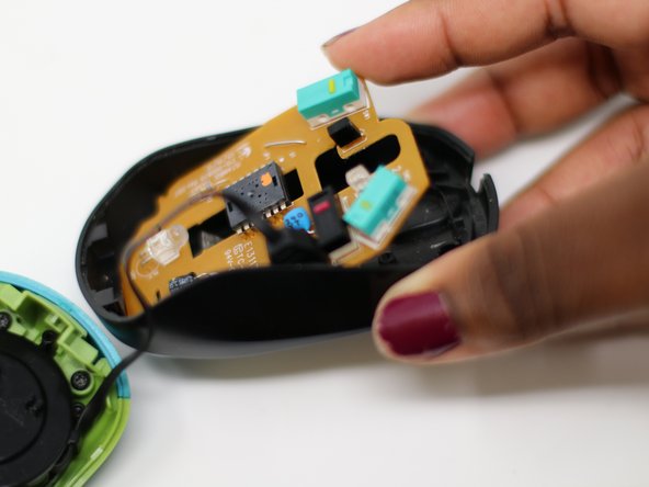

    2. Logitech M125 Power Cord Replacement: crwdns2935265:07crwdnd2935265:01crwdnd2935265:03crwdne2935265:0 Logitech M125 Power Cord Replacement: crwdns2935265:07crwdnd2935265:02crwdnd2935265:03crwdne2935265:0 Logitech M125 Power Cord Replacement: crwdns2935265:07crwdnd2935265:03crwdnd2935265:03crwdne2935265:0
      • Unscrew the silver 0.25mm screws to remove the circuit board from the mouse base with the same screwdriver.
      • Once unscrewed, remove the circuit board.
      • Circuit board needs to be lifted from the front before being pulled forward to remove it

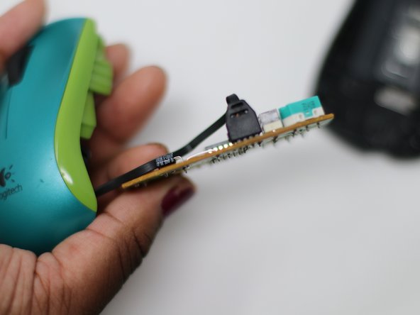

    3. Logitech M125 Power Cord Replacement: crwdns2935265:08crwdnd2935265:01crwdnd2935265:01crwdne2935265:0
      • The cable is soldered into the board and will require a soldering iron to replace.
      • To continue further, please refer to the following guide on how to solder connectors: How To Solder and Desolder Connections.
      • Follow these steps in reverse to reassemble the mouse.
