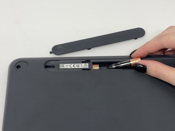

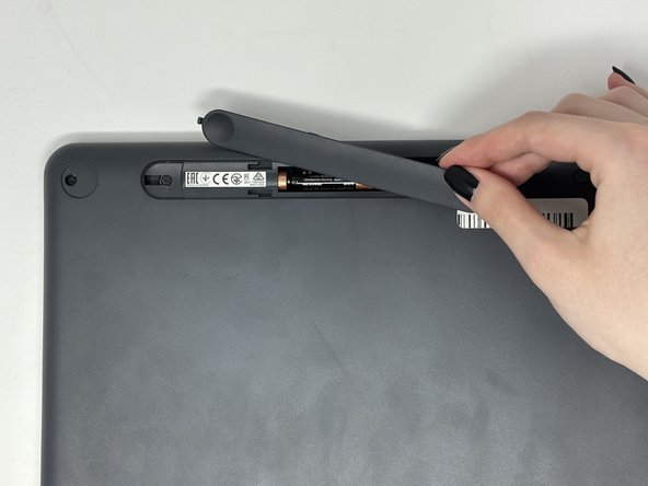

    • Slide open battery panel.
    • Remove the batteries.

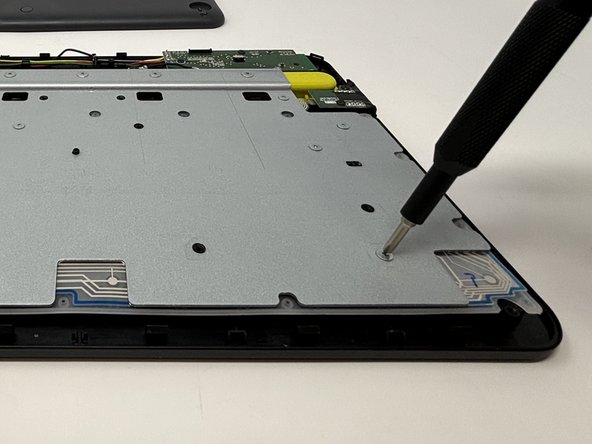

    • Remove the eight 3 mm screws using a Phillips #00 screwdriver
    • Remove the five 2 mm silver screws from the metal plate using a Phillips #00 screwdriver.

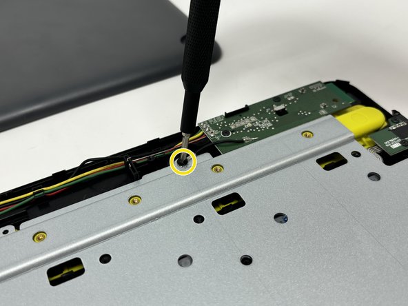

    • Remove the single 4 mm black screw by the motherboard using a Phillips #00 screwdriver.
  8. Logitech K480 Keycap Replacement: crwdns2935265:08crwdnd2935265:01crwdnd2935265:02crwdne2935265:0 Logitech K480 Keycap Replacement: crwdns2935265:08crwdnd2935265:02crwdnd2935265:02crwdne2935265:0
    • Lift up and remove the metal plate.

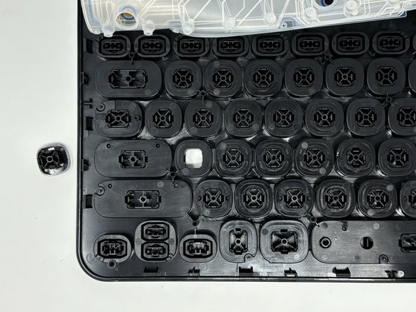

    • Flip the flex circuit and rubber dome sheet over.
  10. Logitech K480 Keycap Replacement: crwdns2935265:010crwdnd2935265:01crwdnd2935265:03crwdne2935265:0 Logitech K480 Keycap Replacement: crwdns2935265:010crwdnd2935265:02crwdnd2935265:03crwdne2935265:0 Logitech K480 Keycap Replacement: crwdns2935265:010crwdnd2935265:03crwdnd2935265:03crwdne2935265:0

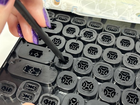

    • Using the spudger, gently press on the underside of the key and pop it out.
