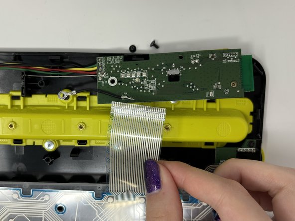

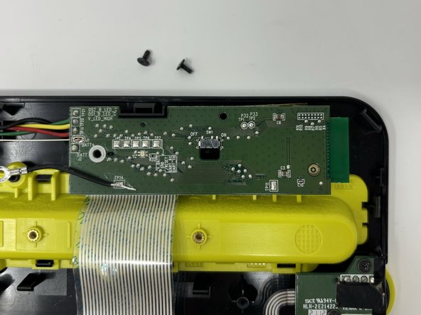

  9. Logitech K480 Flex Circuit Replacement, Flex Circuit: crwdns2935265:09crwdnd2935265:01crwdnd2935265:02crwdne2935265:0 Logitech K480 Flex Circuit Replacement, Flex Circuit: crwdns2935265:09crwdnd2935265:02crwdnd2935265:02crwdne2935265:0
    • Remove the two black 4 mm screws from the motherboard with a Phillips #00 screwdriver.
  10. Logitech K480 Flex Circuit Replacement: crwdns2935265:010crwdnd2935265:01crwdnd2935265:02crwdne2935265:0 Logitech K480 Flex Circuit Replacement: crwdns2935265:010crwdnd2935265:02crwdnd2935265:02crwdne2935265:0
    • Gently pull the flex circuit from the back of the motherboard.
    • The flex circuit is fragile so be gentle when pulling it out.
  11. Logitech K480 Flex Circuit Replacement: crwdns2935265:011crwdnd2935265:01crwdnd2935265:02crwdne2935265:0 Logitech K480 Flex Circuit Replacement: crwdns2935265:011crwdnd2935265:02crwdnd2935265:02crwdne2935265:0
    • Remove the two black 4 mm screws from the dial motherboard below the regular motherboard with a Phillips #00 screwdriver.
  12. Logitech K480 Flex Circuit Replacement: crwdns2935265:012crwdnd2935265:01crwdnd2935265:01crwdne2935265:0
    • Gently pull the circuit sheet from behind the dial motherboard.

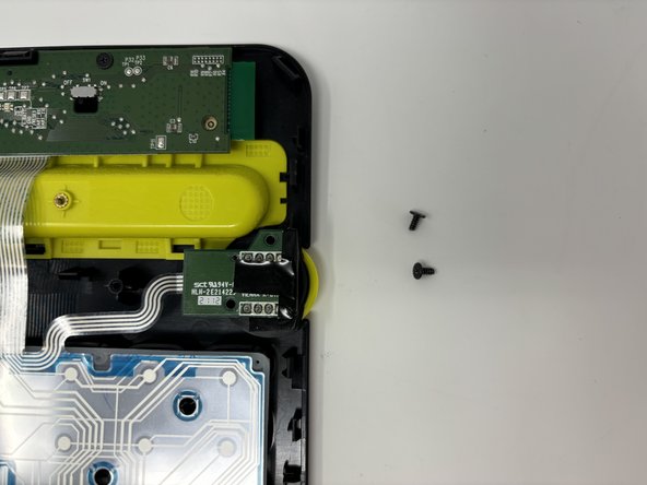

  13. Logitech K480 Flex Circuit Replacement: crwdns2935265:013crwdnd2935265:01crwdnd2935265:01crwdne2935265:0
    • Remove the two black 4 mm screws holding the Bluetooth component on the left side using a Phillips #00 screwdriver.
  14. Logitech K480 Flex Circuit Replacement: crwdns2935265:014crwdnd2935265:01crwdnd2935265:01crwdne2935265:0
    • Lift the flex circuit and remove.
