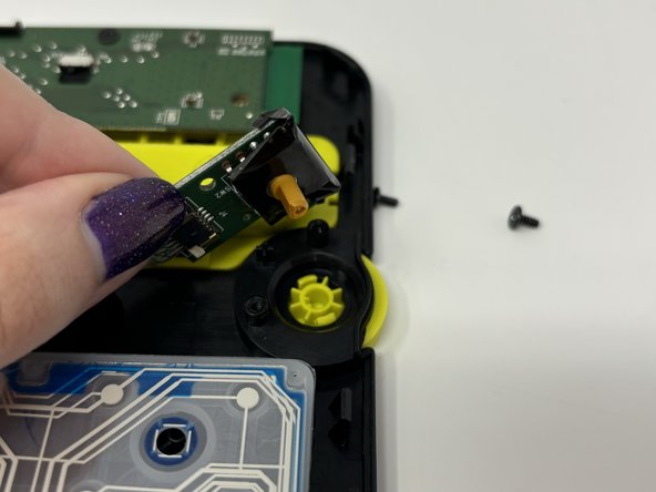

  9. Logitech K480 Easy-Switch Dial Replacement, Easy-Switch Dial: crwdns2935265:09crwdnd2935265:01crwdnd2935265:01crwdne2935265:0
    • Remove the two black 4 mm screws from the dial motherboard located on the upper right corner of the device with the Phillips #00 screwdriver.
  10. Logitech K480 Easy-Switch Dial Replacement: crwdns2935265:010crwdnd2935265:01crwdnd2935265:02crwdne2935265:0 Logitech K480 Easy-Switch Dial Replacement: crwdns2935265:010crwdnd2935265:02crwdnd2935265:02crwdne2935265:0
    • Lift the Easy-Switch motherboard up to pop it out from the dial.
  11. Logitech K480 Easy-Switch Dial Replacement: crwdns2935265:011crwdnd2935265:01crwdnd2935265:03crwdne2935265:0 Logitech K480 Easy-Switch Dial Replacement: crwdns2935265:011crwdnd2935265:02crwdnd2935265:03crwdne2935265:0 Logitech K480 Easy-Switch Dial Replacement: crwdns2935265:011crwdnd2935265:03crwdnd2935265:03crwdne2935265:0
    • Pop out the Easy-Switch dial by gently pressing your finger on the underside of of the dial.
