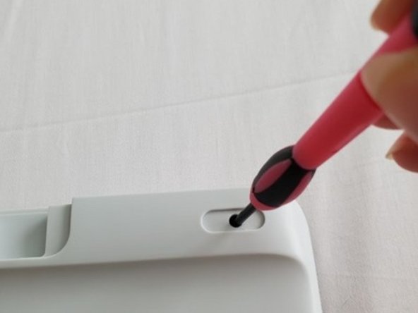

    • Remove the battery port so that the batteries are exposed and take them out.
    • Unscrew the screw that is located in the battery port.

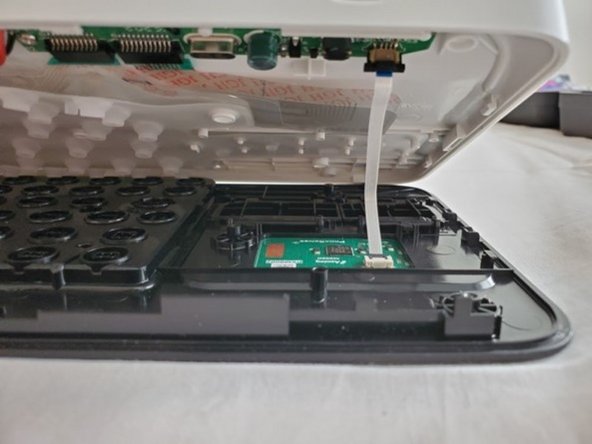

    • Once you have removed all screws from the exterior, the keyboard should be able to split open and come apart.
    • Carefully pry open the keyboard. You can use your screwdriver or any prying tool.

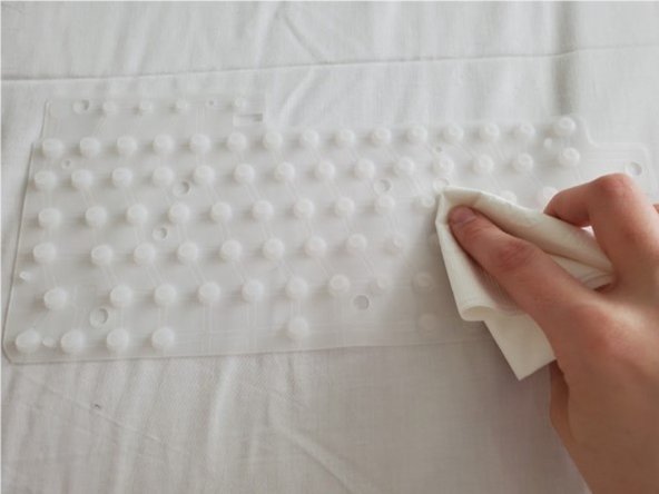

    • Remove the key matrix, which is soft and should be clear or white.
    • Using a dry cloth, lightly wipe off the key matrix.

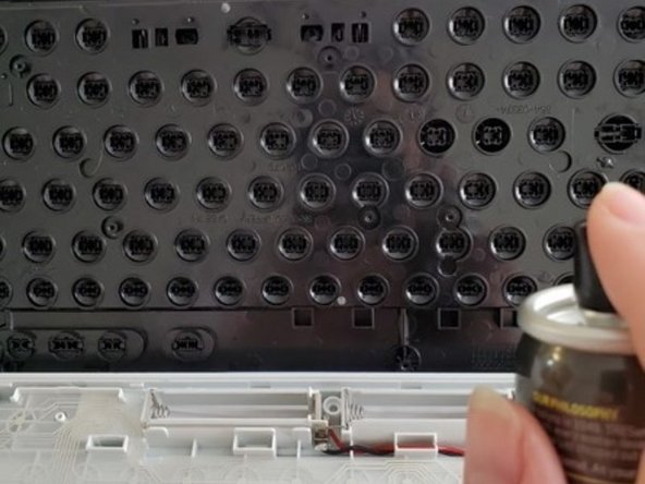

    • Using compressed air, dust in between the key switches and inside the circuit grid.
    • After you have cleaned all components of your keyboard, place the key matrix, key switchboard, and circuit grid back inside the keyboard.
    • Place all screws back into the exterior of the keyboard and screw them in tightly.
    • Place batteries back in battery compartment and close the battery port.
    • Keyboard is reassembled!
