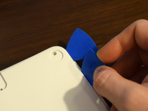

  5. Logitech K380 Disassembly, Insert picks: crwdns2935265:05crwdnd2935265:01crwdnd2935265:03crwdne2935265:0 Logitech K380 Disassembly, Insert picks: crwdns2935265:05crwdnd2935265:02crwdnd2935265:03crwdne2935265:0 Logitech K380 Disassembly, Insert picks: crwdns2935265:05crwdnd2935265:03crwdnd2935265:03crwdne2935265:0
    • Insert a pick between the bottom cover and the outer frame. It's easier to start near the top, where your pick can sink deeper and provide more leverage.
    • Pull the bottom cover up by prying with your pick. You will hear clicks or pops as clips release; this is normal and non-damaging.
    • Once your first pick is wedged between the cover and case, insert a second pick nearby. Slide it around the perimeter, prying as you go to release more clips.
