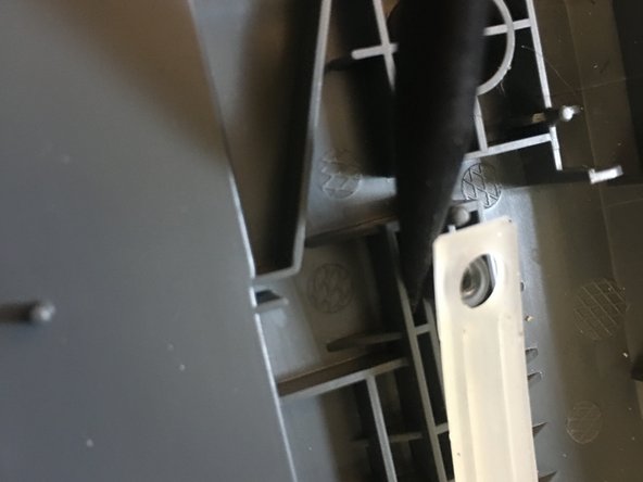

  2. Logitech K120 Keyboard USB Cable Replacement, Separating The Keyboard's Chassis: crwdns2935265:02crwdnd2935265:01crwdnd2935265:03crwdne2935265:0 Logitech K120 Keyboard USB Cable Replacement, Separating The Keyboard's Chassis: crwdns2935265:02crwdnd2935265:02crwdnd2935265:03crwdne2935265:0 Logitech K120 Keyboard USB Cable Replacement, Separating The Keyboard's Chassis: crwdns2935265:02crwdnd2935265:03crwdnd2935265:03crwdne2935265:0
    • Use the spudger to separate the top of keyboard from the bottom of the keyboard.

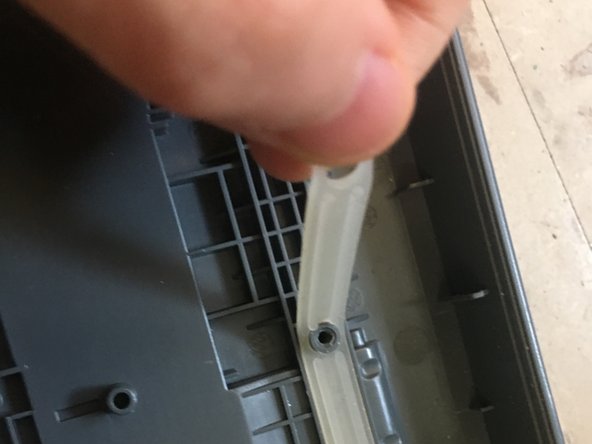

  4. Logitech K120 Keyboard USB Cable Replacement, Removing The Bracket: crwdns2935265:04crwdnd2935265:01crwdnd2935265:03crwdne2935265:0 Logitech K120 Keyboard USB Cable Replacement, Removing The Bracket: crwdns2935265:04crwdnd2935265:02crwdnd2935265:03crwdne2935265:0 Logitech K120 Keyboard USB Cable Replacement, Removing The Bracket: crwdns2935265:04crwdnd2935265:03crwdnd2935265:03crwdne2935265:0
    • Unscrew the highlighted screws using a Phillips #000 Screwdriver. Turn the screwdriver counter-clockwise.

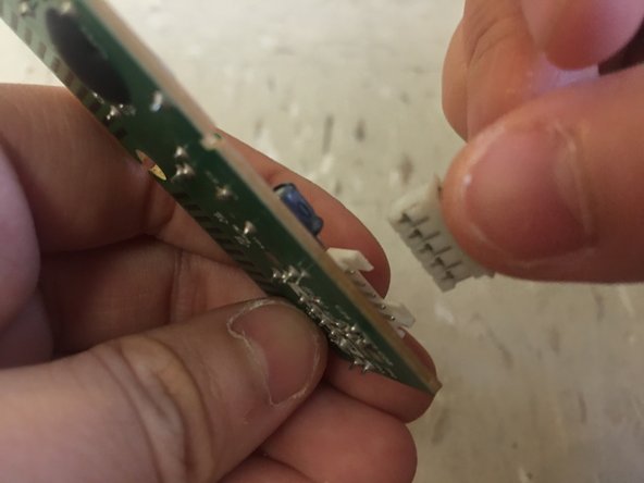

  5. Logitech K120 Keyboard USB Cable Replacement, Removing The Circuit Board: crwdns2935265:05crwdnd2935265:01crwdnd2935265:03crwdne2935265:0 Logitech K120 Keyboard USB Cable Replacement, Removing The Circuit Board: crwdns2935265:05crwdnd2935265:02crwdnd2935265:03crwdne2935265:0 Logitech K120 Keyboard USB Cable Replacement, Removing The Circuit Board: crwdns2935265:05crwdnd2935265:03crwdnd2935265:03crwdne2935265:0
    • Use the spudger and carefully pry the connector out of its socket. (Highlighted in the pictures)

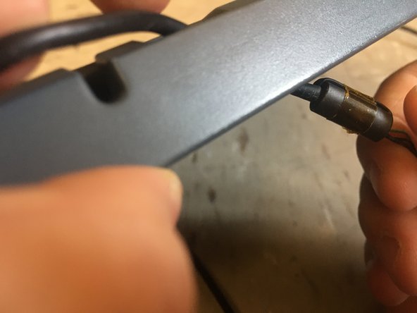

  6. Logitech K120 Keyboard USB Cable Replacement, Removing The Cable: crwdns2935265:06crwdnd2935265:01crwdnd2935265:02crwdne2935265:0 Logitech K120 Keyboard USB Cable Replacement, Removing The Cable: crwdns2935265:06crwdnd2935265:02crwdnd2935265:02crwdne2935265:0
    • Carefully nudge the connector out of the hole in which the cable enters the keyboard's chassis.

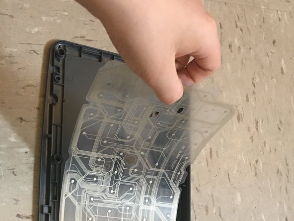

  7. Logitech K120 Keyboard USB Cable Replacement, Removing The Membrane: crwdns2935265:07crwdnd2935265:01crwdnd2935265:02crwdne2935265:0 Logitech K120 Keyboard USB Cable Replacement, Removing The Membrane: crwdns2935265:07crwdnd2935265:02crwdnd2935265:02crwdne2935265:0
    • Peel the membrane off carefully so that the membrane doesn't rip.

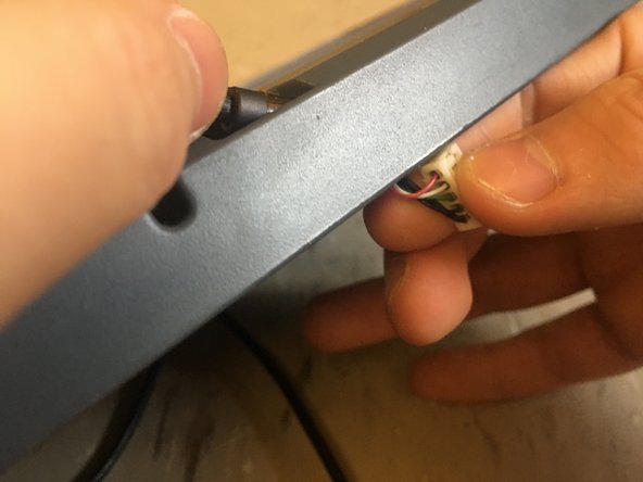

  9. Logitech K120 Keyboard USB Cable Replacement, Install The New Cable: crwdns2935265:09crwdnd2935265:01crwdnd2935265:03crwdne2935265:0 Logitech K120 Keyboard USB Cable Replacement, Install The New Cable: crwdns2935265:09crwdnd2935265:02crwdnd2935265:03crwdne2935265:0 Logitech K120 Keyboard USB Cable Replacement, Install The New Cable: crwdns2935265:09crwdnd2935265:03crwdnd2935265:03crwdne2935265:0
    • Slide the new cable into the hole.
  10. Logitech K120 Keyboard USB Cable Replacement, Connect The New Cable: crwdns2935265:010crwdnd2935265:01crwdnd2935265:03crwdne2935265:0 Logitech K120 Keyboard USB Cable Replacement, Connect The New Cable: crwdns2935265:010crwdnd2935265:02crwdnd2935265:03crwdne2935265:0 Logitech K120 Keyboard USB Cable Replacement, Connect The New Cable: crwdns2935265:010crwdnd2935265:03crwdnd2935265:03crwdne2935265:0
    • Connect The Cable To The Circuit Board.
