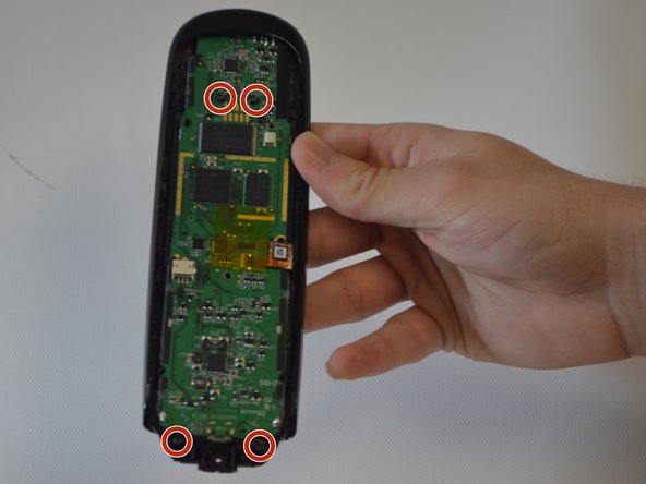

  8. Logitech Harmony Ultimate Motherboard Replacement, Motherboard: crwdns2935265:08crwdnd2935265:01crwdnd2935265:02crwdne2935265:0 Logitech Harmony Ultimate Motherboard Replacement, Motherboard: crwdns2935265:08crwdnd2935265:02crwdnd2935265:02crwdne2935265:0
    • Remove the four 6mm Phillips #0 screws from the motherboard.
  9. Logitech Harmony Ultimate Motherboard Replacement: crwdns2935265:09crwdnd2935265:01crwdnd2935265:02crwdne2935265:0 Logitech Harmony Ultimate Motherboard Replacement: crwdns2935265:09crwdnd2935265:02crwdnd2935265:02crwdne2935265:0
    • There is a flap that connects to the motherboard from the plastic casing. Use fingernails to safely release the flap by flipping the small black buckle upwards.
    • The flap and buckle are underneath the clear yellow piece of tape.
    • Be very careful as damaging this flap could permanently damage your controller.
  10. Logitech Harmony Ultimate Motherboard Replacement: crwdns2935265:010crwdnd2935265:01crwdnd2935265:01crwdne2935265:0
    • The motherboard is now safe to remove by sliding and lifting it backwards out of place.
