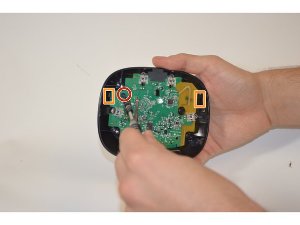

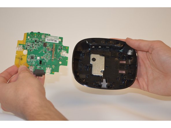

  3. Logitech Harmony Ultimate Harmony Hub Motherboard Replacement, Motherboard: crwdns2935265:03crwdnd2935265:01crwdnd2935265:03crwdne2935265:0 Logitech Harmony Ultimate Harmony Hub Motherboard Replacement, Motherboard: crwdns2935265:03crwdnd2935265:02crwdnd2935265:03crwdne2935265:0 Logitech Harmony Ultimate Harmony Hub Motherboard Replacement, Motherboard: crwdns2935265:03crwdnd2935265:03crwdnd2935265:03crwdne2935265:0
    • Remove the single 6 mm Phillips #0 screw from the motherboard.
    • Pull the black tabs back and lift the motherboard.
