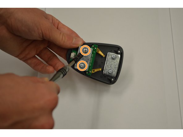

    • Remove the two (4mm) screws using Phillips 1 screwdriver.

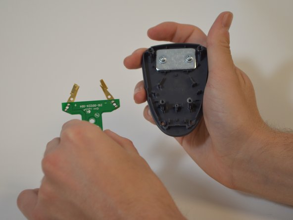

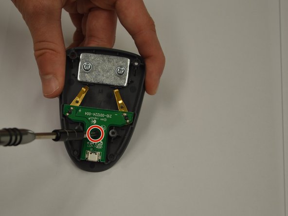

    • Use the Phillips #0 screwdriver to remove the last (4mm) screw. The motherboard can now be removed.
