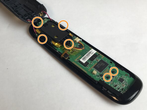

    • Open the latch that covers the charging port.
    • Remove the black sticker, then remove the screw with the indicated screwdriver.
    • Take the plastic opening tool, and run it down the side of the remote to pop the case open.
    • While doing this step, there are three wires that connect the two pieces. Be sure not to rip the wires out.
    • Detach the white clamp in order to partially disconnect the case from the motherboard.

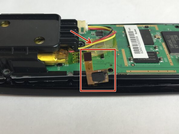

  2. Logitech Harmony Touch Motherboard Replacement: crwdns2935265:02crwdnd2935265:01crwdnd2935265:03crwdne2935265:0 Logitech Harmony Touch Motherboard Replacement: crwdns2935265:02crwdnd2935265:02crwdnd2935265:03crwdne2935265:0 Logitech Harmony Touch Motherboard Replacement: crwdns2935265:02crwdnd2935265:03crwdnd2935265:03crwdne2935265:0

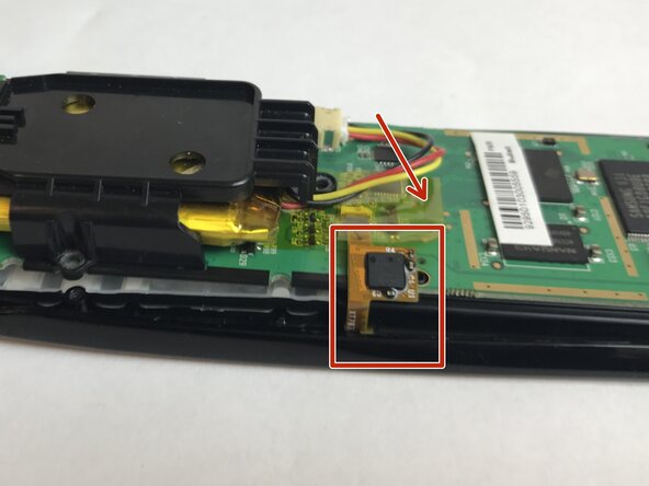

    • Peel back the thin yellow plastic film and detach the clip found underneath.
    • Remove the screws that connect the motherboard to the case with the suggested screwdriver.
    • Next, carefully remove the motherboard from the top piece of the case.
    • The motherboard is connected to the bottom part of the case.
    • You should now be able to access all of the buttons and remove them from the case.
