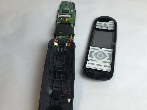

    • Open the latch that accesses the charging port.
    • Remove the black sticker and the screw with the Phillips #0 Screwdriver.
    • Take the plastic opening tool and run it down the side of the remote to open the case.
    • While doing this step, three wires connect the two pieces, be sure not to rip them out.
    • Detach the white clamp to disconnect the case from the motherboard partially.

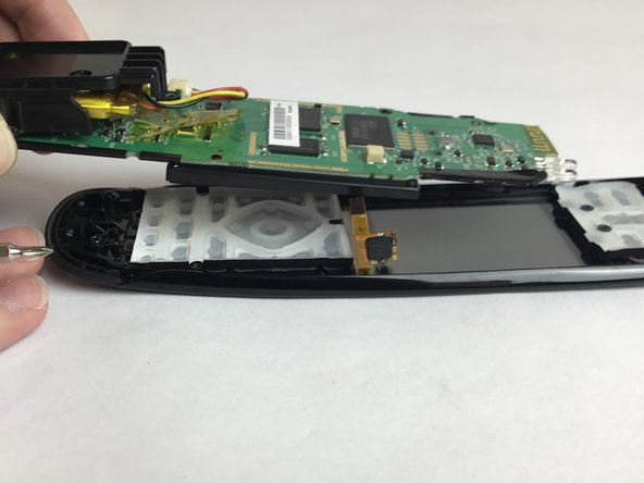

  2. Logitech Harmony Touch Buttons Replacement: crwdns2935265:02crwdnd2935265:01crwdnd2935265:03crwdne2935265:0 Logitech Harmony Touch Buttons Replacement: crwdns2935265:02crwdnd2935265:02crwdnd2935265:03crwdne2935265:0 Logitech Harmony Touch Buttons Replacement: crwdns2935265:02crwdnd2935265:03crwdnd2935265:03crwdne2935265:0
    • Peel back the thin yellow plastic film.
    • Detach the clip found underneath the film.
    • Remove the screws that connect the motherboard to the case with the Phillips #0 Screwdriver.
  3. Logitech Harmony Touch Buttons Replacement: crwdns2935265:03crwdnd2935265:01crwdnd2935265:03crwdne2935265:0 Logitech Harmony Touch Buttons Replacement: crwdns2935265:03crwdnd2935265:02crwdnd2935265:03crwdne2935265:0 Logitech Harmony Touch Buttons Replacement: crwdns2935265:03crwdnd2935265:03crwdnd2935265:03crwdne2935265:0
    • Next, carefully remove the motherboard from the top piece of the case.
    • The motherboard is connected to the bottom part of the case.
    • You should now be able to access all the buttons and remove them from the case.

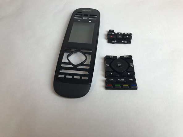

  4. Logitech Harmony Touch Buttons Replacement: crwdns2935265:04crwdnd2935265:01crwdnd2935265:02crwdne2935265:0 Logitech Harmony Touch Buttons Replacement: crwdns2935265:04crwdnd2935265:02crwdnd2935265:02crwdne2935265:0
    • Remove the buttons from the case.
