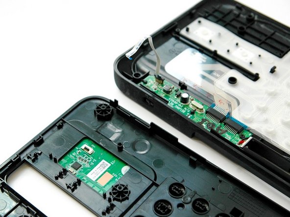

    • Wedge the flat end of the spudger between the back panel and front panel.
    • Slide the flat end of the spudger from right to left to pry the two panels apart.
  9. Logitech Harmony Smart Keyboard Touchpad Printed Circuit Board (PCB) Replacement: crwdns2935265:09crwdnd2935265:01crwdnd2935265:03crwdne2935265:0 Logitech Harmony Smart Keyboard Touchpad Printed Circuit Board (PCB) Replacement: crwdns2935265:09crwdnd2935265:02crwdnd2935265:03crwdne2935265:0 Logitech Harmony Smart Keyboard Touchpad Printed Circuit Board (PCB) Replacement: crwdns2935265:09crwdnd2935265:03crwdnd2935265:03crwdne2935265:0
    • Separate the back panel from the front panel completely, using both hands.
    • A white ribbon flex cable will remain connected to both panels.
    • Pull the panels apart slowly and gently, or the white ribbon flex cable may be unsafely removed.

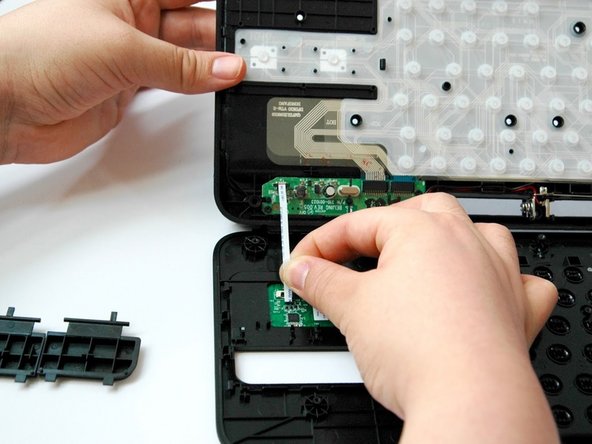

  10. Logitech Harmony Smart Keyboard Touchpad Printed Circuit Board (PCB) Replacement, Touchpad Printed Circuit Board (PCB): crwdns2935265:010crwdnd2935265:01crwdnd2935265:03crwdne2935265:0 Logitech Harmony Smart Keyboard Touchpad Printed Circuit Board (PCB) Replacement, Touchpad Printed Circuit Board (PCB): crwdns2935265:010crwdnd2935265:02crwdnd2935265:03crwdne2935265:0 Logitech Harmony Smart Keyboard Touchpad Printed Circuit Board (PCB) Replacement, Touchpad Printed Circuit Board (PCB): crwdns2935265:010crwdnd2935265:03crwdnd2935265:03crwdne2935265:0
    • Lift up and pull off the track pad’s left and right clickers.
    • Use caution while lifting, lift slowly with slight pressure.
  11. Logitech Harmony Smart Keyboard Touchpad Printed Circuit Board (PCB) Replacement: crwdns2935265:011crwdnd2935265:01crwdnd2935265:03crwdne2935265:0 Logitech Harmony Smart Keyboard Touchpad Printed Circuit Board (PCB) Replacement: crwdns2935265:011crwdnd2935265:02crwdnd2935265:03crwdne2935265:0 Logitech Harmony Smart Keyboard Touchpad Printed Circuit Board (PCB) Replacement: crwdns2935265:011crwdnd2935265:03crwdnd2935265:03crwdne2935265:0
    • Grip the lower end of the ribbon flex cable (white band) using your thumb and index finger.
    • Then slide the strip out toward yourself in a scooping motion.
    • Now, you should have two completely separated panel pieces.

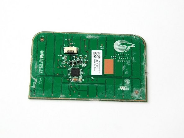

  15. Logitech Harmony Smart Keyboard Touchpad Printed Circuit Board (PCB) Replacement: crwdns2935265:015crwdnd2935265:01crwdnd2935265:03crwdne2935265:0 Logitech Harmony Smart Keyboard Touchpad Printed Circuit Board (PCB) Replacement: crwdns2935265:015crwdnd2935265:02crwdnd2935265:03crwdne2935265:0 Logitech Harmony Smart Keyboard Touchpad Printed Circuit Board (PCB) Replacement: crwdns2935265:015crwdnd2935265:03crwdnd2935265:03crwdne2935265:0
    • Wedge the flat-head metal spudger under the PCB's bottom-left corner.
    • Wedge and slide the spudger along the bottom side to reach the bottom-right corner.

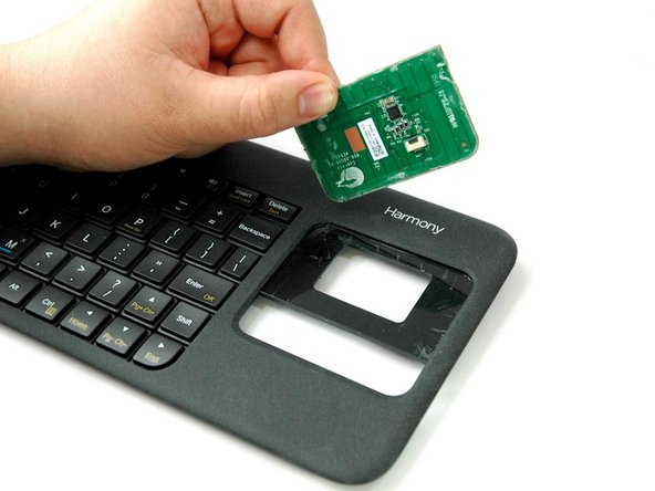

  16. Logitech Harmony Smart Keyboard Touchpad Printed Circuit Board (PCB) Replacement: crwdns2935265:016crwdnd2935265:01crwdnd2935265:03crwdne2935265:0 Logitech Harmony Smart Keyboard Touchpad Printed Circuit Board (PCB) Replacement: crwdns2935265:016crwdnd2935265:02crwdnd2935265:03crwdne2935265:0 Logitech Harmony Smart Keyboard Touchpad Printed Circuit Board (PCB) Replacement: crwdns2935265:016crwdnd2935265:03crwdnd2935265:03crwdne2935265:0
    • Slide and nudge the spudger upward underneath the PCB.
    • Wiggle and lift up the PCB with your thumb as you nudge the spudger up to release the PCB.
