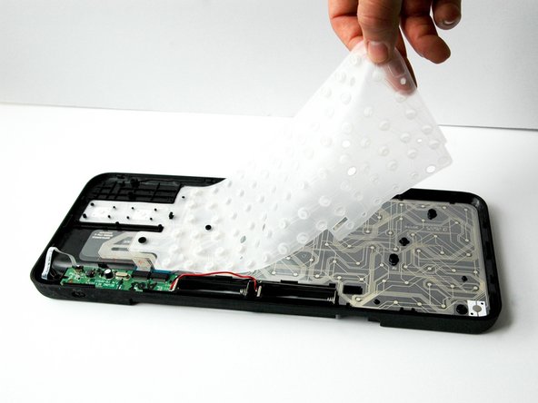

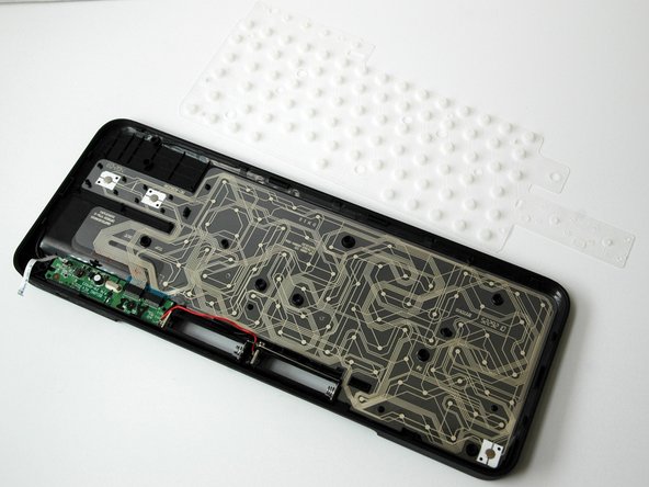

    • Lift and remove the white rubber sheet that lays over the keyboard pet flexible PCB.
  12. Logitech Harmony Smart Keyboard Key Printed Circuit Board (PCB) Replacement: crwdns2935265:012crwdnd2935265:01crwdnd2935265:03crwdne2935265:0 Logitech Harmony Smart Keyboard Key Printed Circuit Board (PCB) Replacement: crwdns2935265:012crwdnd2935265:02crwdnd2935265:03crwdne2935265:0 Logitech Harmony Smart Keyboard Key Printed Circuit Board (PCB) Replacement: crwdns2935265:012crwdnd2935265:03crwdnd2935265:03crwdne2935265:0

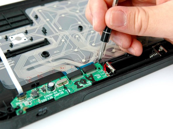

    • Unscrew the two 4.0 mm screws on either side of the green card using a Phillips #1 screwdriver.
  13. Logitech Harmony Smart Keyboard Key Printed Circuit Board (PCB) Replacement: crwdns2935265:013crwdnd2935265:01crwdnd2935265:01crwdne2935265:0
    • Lift the green card up using the flat end of the plastic spudger.
  14. Logitech Harmony Smart Keyboard Key Printed Circuit Board (PCB) Replacement: crwdns2935265:014crwdnd2935265:01crwdnd2935265:01crwdne2935265:0
    • Grip and lift the keyboard PCB up and out.
    • The battery wires will remain connected.
