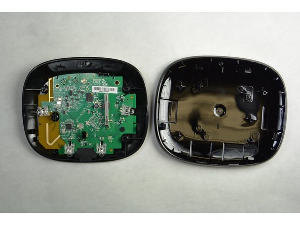

    • With the plastic opening tool, separate the pieces of plastic from each other

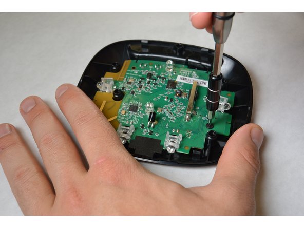

  4. Logitech Harmony Smart Control Reset Button Replacement: crwdns2935265:04crwdnd2935265:01crwdnd2935265:02crwdne2935265:0 Logitech Harmony Smart Control Reset Button Replacement: crwdns2935265:04crwdnd2935265:02crwdnd2935265:02crwdne2935265:0
    • With the PH00 bit, remove the three 4mm Phillips screws.

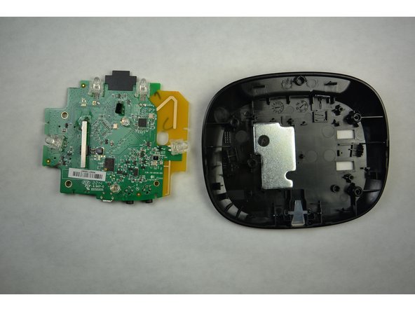

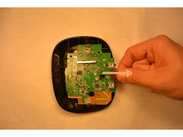

  5. Logitech Harmony Smart Control Reset Button Replacement: crwdns2935265:05crwdnd2935265:01crwdnd2935265:03crwdne2935265:0 Logitech Harmony Smart Control Reset Button Replacement: crwdns2935265:05crwdnd2935265:02crwdnd2935265:03crwdne2935265:0 Logitech Harmony Smart Control Reset Button Replacement: crwdns2935265:05crwdnd2935265:03crwdnd2935265:03crwdne2935265:0
    • From the yellow corner, pry the circuit board from the housing..

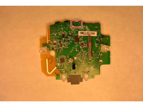

  6. Logitech Harmony Smart Control Reset Button Replacement: crwdns2935265:06crwdnd2935265:01crwdnd2935265:03crwdne2935265:0 Logitech Harmony Smart Control Reset Button Replacement: crwdns2935265:06crwdnd2935265:02crwdnd2935265:03crwdne2935265:0 Logitech Harmony Smart Control Reset Button Replacement: crwdns2935265:06crwdnd2935265:03crwdnd2935265:03crwdne2935265:0
    • Locate the defective reset button.
    • Turn the board around to expose the reset solder.
    • Using soldering iron, remove solder and reset button. Replace reset button and solder.
