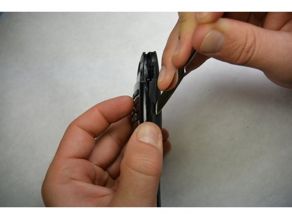

    3. Logitech Harmony Smart Control Remote Buttons Replacement: crwdns2935265:03crwdnd2935265:01crwdnd2935265:02crwdne2935265:0 Logitech Harmony Smart Control Remote Buttons Replacement: crwdns2935265:03crwdnd2935265:02crwdnd2935265:02crwdne2935265:0
      • Using a metal spudger, pry the remote. Maneuver around to separate both sides.

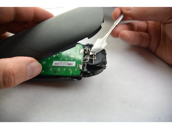

    4. Logitech Harmony Smart Control Remote Buttons Replacement: crwdns2935265:04crwdnd2935265:01crwdnd2935265:03crwdne2935265:0 Logitech Harmony Smart Control Remote Buttons Replacement: crwdns2935265:04crwdnd2935265:02crwdnd2935265:03crwdne2935265:0 Logitech Harmony Smart Control Remote Buttons Replacement: crwdns2935265:04crwdnd2935265:03crwdnd2935265:03crwdne2935265:0
      • Manualy separate the two pieces of plastic.
      • Using the metal piece from the housing, pry up the circuit board. Do not disconnect anything.
      • When the circuit board is pried, slide the circuit board out of the housing.
    5. Logitech Harmony Smart Control Remote Buttons Replacement: crwdns2935265:05crwdnd2935265:01crwdnd2935265:01crwdne2935265:0
      • From the front of the remote, remove the buttons. Clean or replace the necessary buttons.
