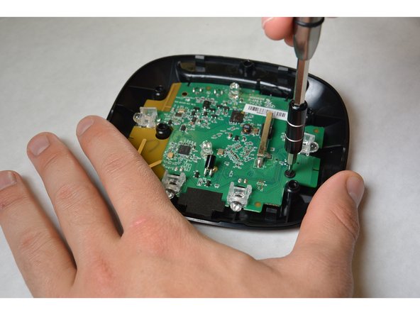

    • Use the PH00 screwdriver bit to unscrew the three 4mm Phillips screws on the control board.

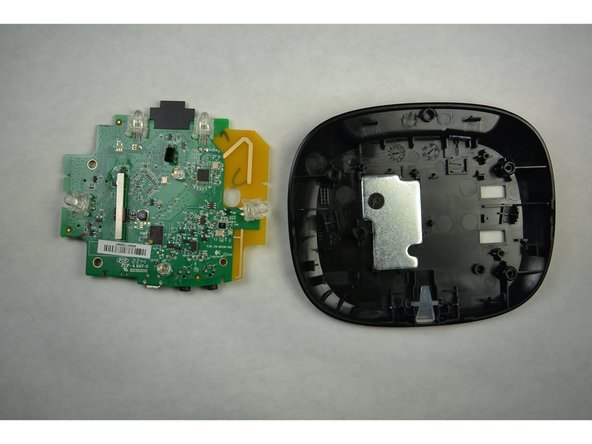

    • Place the end of the opening tool under the yellow corner of the circuit board as shown.
    • Gently push upward to pry the board from its housing.
  6. Logitech Harmony Smart Control Hub Light Bulb Replacement: crwdns2935265:06crwdnd2935265:01crwdnd2935265:03crwdne2935265:0 Logitech Harmony Smart Control Hub Light Bulb Replacement: crwdns2935265:06crwdnd2935265:02crwdnd2935265:03crwdne2935265:0 Logitech Harmony Smart Control Hub Light Bulb Replacement: crwdns2935265:06crwdnd2935265:03crwdnd2935265:03crwdne2935265:0
    • Determine which of the five bulbs are defective.
    • Turn the board over to expose the bulb solder.
    • Using a soldering iron, remove the solder and bulb. Replace with a new bulb and re-solder.
