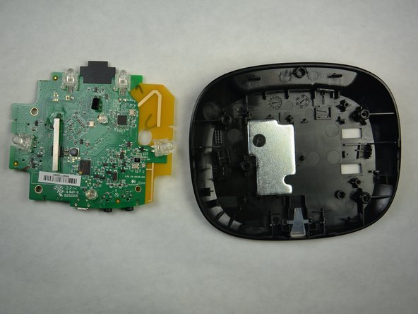

    • Use the plastic opening tool to pry open and separate the pieces of plastic from each other.
  4. Logitech Harmony Smart Control Charging Port Replacement: crwdns2935265:04crwdnd2935265:01crwdnd2935265:02crwdne2935265:0 Logitech Harmony Smart Control Charging Port Replacement: crwdns2935265:04crwdnd2935265:02crwdnd2935265:02crwdne2935265:0
    • Using the PH00 bit, remove the three 4mm Phillips screws.
  5. Logitech Harmony Smart Control Charging Port Replacement: crwdns2935265:05crwdnd2935265:01crwdnd2935265:03crwdne2935265:0 Logitech Harmony Smart Control Charging Port Replacement: crwdns2935265:05crwdnd2935265:02crwdnd2935265:03crwdne2935265:0 Logitech Harmony Smart Control Charging Port Replacement: crwdns2935265:05crwdnd2935265:03crwdnd2935265:03crwdne2935265:0

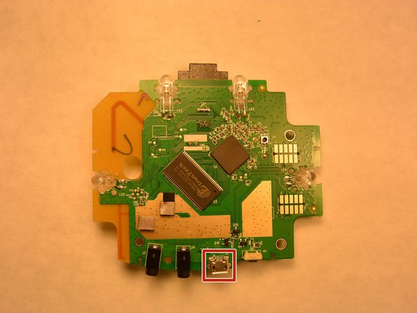

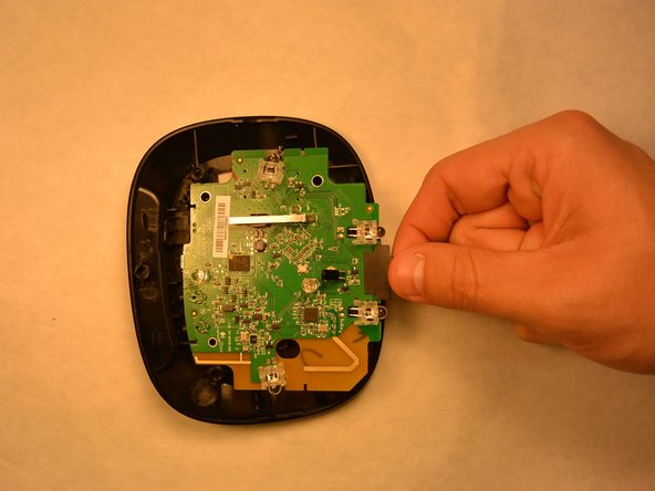

    • Starting at the yellow corner, use a plastic opening tool to pry the circuit board from the housing.

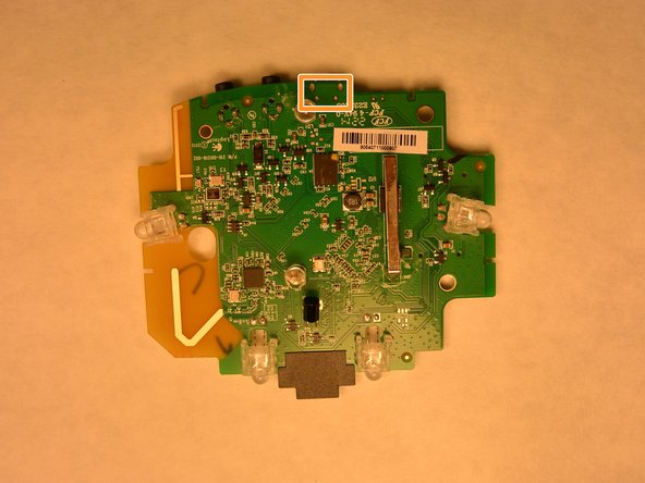

  6. Logitech Harmony Smart Control Charging Port Replacement: crwdns2935265:06crwdnd2935265:01crwdnd2935265:03crwdne2935265:0 Logitech Harmony Smart Control Charging Port Replacement: crwdns2935265:06crwdnd2935265:02crwdnd2935265:03crwdne2935265:0 Logitech Harmony Smart Control Charging Port Replacement: crwdns2935265:06crwdnd2935265:03crwdnd2935265:03crwdne2935265:0
    • Locate the defective charging port.
    • Turn the circuit board over to expose the charging solder.
    • Using a soldering iron, remove the solder and the charging port. Install a new charging port and solder.
