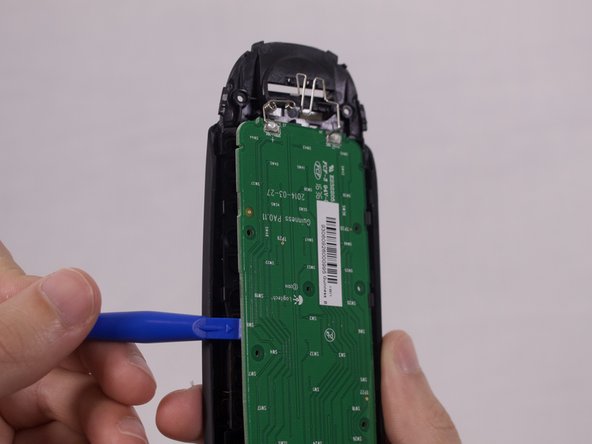

  4. Logitech Harmony Companion Remote Motherboard Replacement, Remote Motherboard: crwdns2935265:04crwdnd2935265:01crwdnd2935265:02crwdne2935265:0 Logitech Harmony Companion Remote Motherboard Replacement, Remote Motherboard: crwdns2935265:04crwdnd2935265:02crwdnd2935265:02crwdne2935265:0
    • Remove the two 5.0 mm Phillips #0 screws.
  5. Logitech Harmony Companion Remote Motherboard Replacement: crwdns2935265:05crwdnd2935265:01crwdnd2935265:02crwdne2935265:0 Logitech Harmony Companion Remote Motherboard Replacement: crwdns2935265:05crwdnd2935265:02crwdnd2935265:02crwdne2935265:0
    • Use the plastic opening tool to pry open the back cover of the remote.
    • It is recommended to have the point of the opening tool facing the back of the remote.
    • Insert the opening tool on each side of the bottom of the remote, and pull up until you hear the cover click open.
    • Pry the back cover off by sliding the plastic opening tool down each side.
  6. Logitech Harmony Companion Remote Motherboard Replacement: crwdns2935265:06crwdnd2935265:01crwdnd2935265:02crwdne2935265:0 Logitech Harmony Companion Remote Motherboard Replacement: crwdns2935265:06crwdnd2935265:02crwdnd2935265:02crwdne2935265:0
    • Use the plastic opening tool to remove the motherboard.
