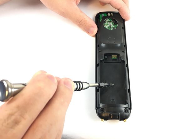

  2. Logitech Harmony 950 Motherboard Replacement: crwdns2935265:02crwdnd2935265:01crwdnd2935265:03crwdne2935265:0 Logitech Harmony 950 Motherboard Replacement: crwdns2935265:02crwdnd2935265:02crwdnd2935265:03crwdne2935265:0 Logitech Harmony 950 Motherboard Replacement: crwdns2935265:02crwdnd2935265:03crwdnd2935265:03crwdne2935265:0
    • Use the Phillips #0 Screwdriver to remove the (2) two 6mm screws.
    • Pull the bottom cover off of the remote control.

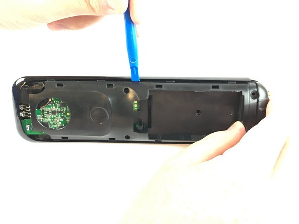

  3. Logitech Harmony 950 Motherboard Replacement: crwdns2935265:03crwdnd2935265:01crwdnd2935265:03crwdne2935265:0 Logitech Harmony 950 Motherboard Replacement: crwdns2935265:03crwdnd2935265:02crwdnd2935265:03crwdne2935265:0 Logitech Harmony 950 Motherboard Replacement: crwdns2935265:03crwdnd2935265:03crwdnd2935265:03crwdne2935265:0
    • Use the Phillips #1 Screwdriver to remove the (2) two 6mm screws.
    • There should be a gap on each side to fit the Opening Tool. Use the Opening Tool to open the back cover (Soft Touch cover) using the gap.

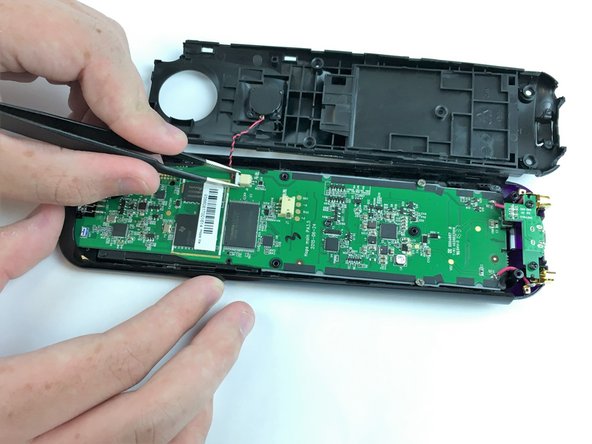

  6. Logitech Harmony 950 Motherboard Replacement: crwdns2935265:06crwdnd2935265:01crwdnd2935265:03crwdne2935265:0 Logitech Harmony 950 Motherboard Replacement: crwdns2935265:06crwdnd2935265:02crwdnd2935265:03crwdne2935265:0 Logitech Harmony 950 Motherboard Replacement: crwdns2935265:06crwdnd2935265:03crwdnd2935265:03crwdne2935265:0
    $3.99
    • Carefully remove the back cover and place it next to the remote. Be careful not to detach the wire during this process.
    • Use the angled Tweezers to carefully pull the white cable end off of the remote and disconnect it.

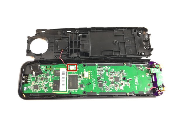

  7. Logitech Harmony 950 Motherboard Replacement: crwdns2935265:07crwdnd2935265:01crwdnd2935265:03crwdne2935265:0 Logitech Harmony 950 Motherboard Replacement: crwdns2935265:07crwdnd2935265:02crwdnd2935265:03crwdne2935265:0 Logitech Harmony 950 Motherboard Replacement: crwdns2935265:07crwdnd2935265:03crwdnd2935265:03crwdne2935265:0
    • Use the Phillips #0 screwdriver to remove the (5) five 6mm screws.
    • Be careful not to detach the pink wires when removing the gold charging conductors.

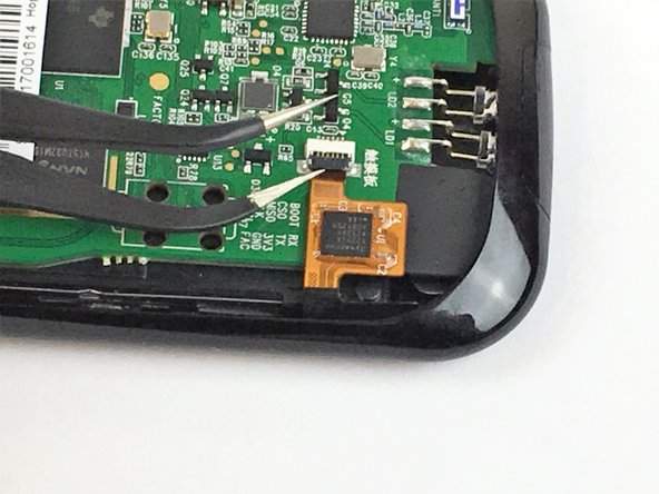

  8. Logitech Harmony 950 Motherboard Replacement: crwdns2935265:08crwdnd2935265:01crwdnd2935265:03crwdne2935265:0 Logitech Harmony 950 Motherboard Replacement: crwdns2935265:08crwdnd2935265:02crwdnd2935265:03crwdne2935265:0 Logitech Harmony 950 Motherboard Replacement: crwdns2935265:08crwdnd2935265:03crwdnd2935265:03crwdne2935265:0
    • Remove the black tape to access the cable underneath.
    • Use the Angled Tweezers to lift the black lock.
    • Slide the yellow cable to disconnect it from the circuit board.

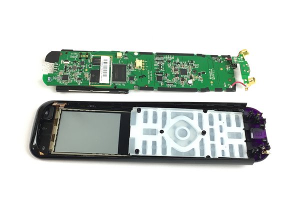

  9. Logitech Harmony 950 Motherboard Replacement: crwdns2935265:09crwdnd2935265:01crwdnd2935265:02crwdne2935265:0 Logitech Harmony 950 Motherboard Replacement: crwdns2935265:09crwdnd2935265:02crwdnd2935265:02crwdne2935265:0
    • Pull the circuit board off of the remote from the bottom, and lift up to detach it from the cover.
