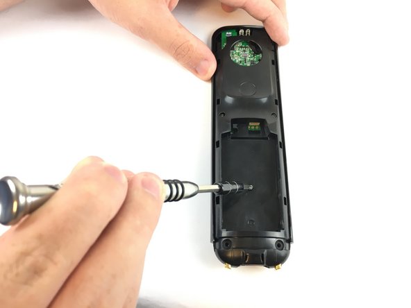

  3. Logitech Harmony 950 Keypad Replacement: crwdns2935265:03crwdnd2935265:01crwdnd2935265:03crwdne2935265:0 Logitech Harmony 950 Keypad Replacement: crwdns2935265:03crwdnd2935265:02crwdnd2935265:03crwdne2935265:0 Logitech Harmony 950 Keypad Replacement: crwdns2935265:03crwdnd2935265:03crwdnd2935265:03crwdne2935265:0

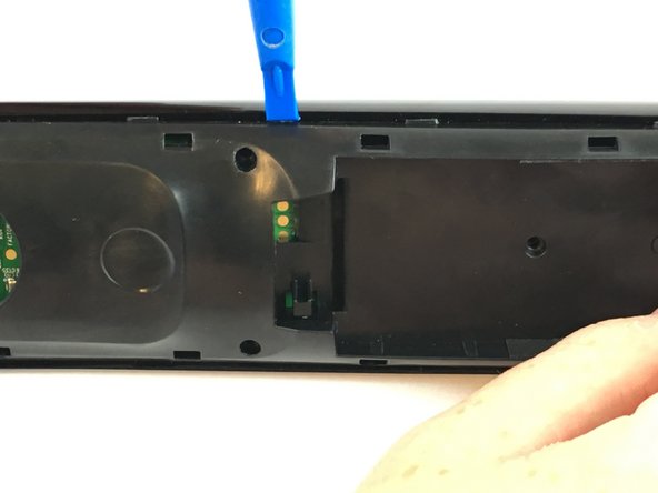

    • Use the Phillips #1 Screwdriver to remove the (2) two 6mm screws.
    • There should be a gap on each side to fit the Opening Tool. Use the Opening Tool to open the back cover (Soft Touch cover) using the gap.

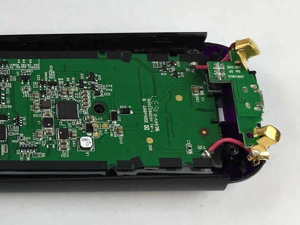

    • Use the J0 Philips Head Screwdriver to remove the 5 6mm screws.
    • Be careful not to detach the pink wires when removing the gold charging conductors.

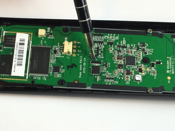

    • Remove the black tape to access the cable underneath.
    • Use the angled tweezers to flip the black lock up 90° and release the cable.
    • Slide the yellow cable to disconnect it from the circuit board.

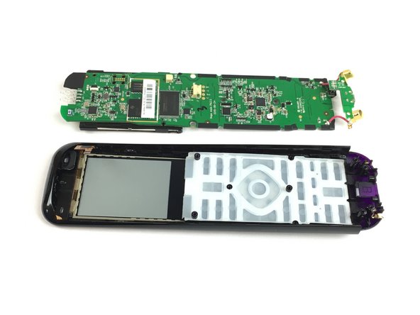

  9. Logitech Harmony 950 Keypad Replacement: crwdns2935265:09crwdnd2935265:01crwdnd2935265:02crwdne2935265:0 Logitech Harmony 950 Keypad Replacement: crwdns2935265:09crwdnd2935265:02crwdnd2935265:02crwdne2935265:0
    • Pull the circuit board off of the remote from the bottom, and lift up to detach it from the cover.
    • It can be difficult to detach the circuit board without damaging the connectors. If you just need access to the keypad, lift the board up starting with the bottom, until you can hinge the top end off. Use a tool or pick to hold the board up until you replace it.
  10. Logitech Harmony 950 Keypad Replacement: crwdns2935265:010crwdnd2935265:01crwdnd2935265:02crwdne2935265:0 Logitech Harmony 950 Keypad Replacement: crwdns2935265:010crwdnd2935265:02crwdnd2935265:02crwdne2935265:0
    • Use the Blunt Tweezers to carefully remove the keypad from the cover of the remote.

Some feedback on the guide. Once you access the PCB, and you need to remove the gold charging conductors at the bottom. Mine didn't come out, they both seem hooked in. So in the end I left them in and wiggled the PCB out instead. I think you might need to break the small plastic pits that hold in the charging conductors .
Jonathan Willis - crwdns2934203:0crwdne2934203:0
I agree with Jonathan, it is not possible to remove the gold charging conductors without breaking the small centered plastic pin that is holding them. However taking it appart and having the buttons a bit loose once the screws where removed did the trick!
Armand - crwdns2934203:0crwdne2934203:0
Just a smaller comment - step 7 picture 1 shows the position of the three screws. The one in the middle on the PCB is not pictured correctly.
