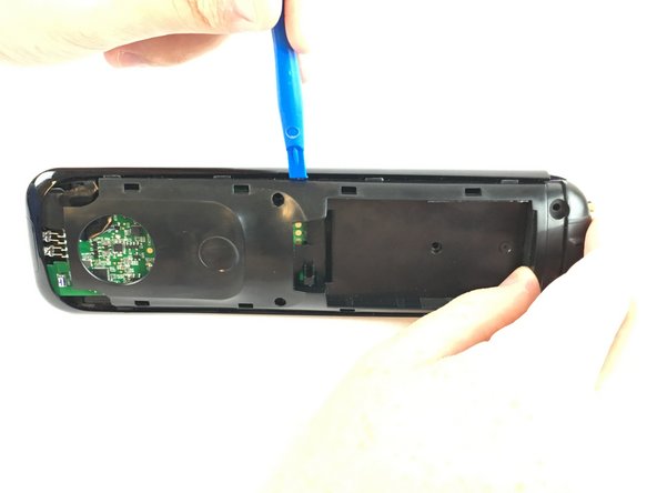

    • Make sure the remote control is powered off before starting.
    • Use the Opening Tool to open the port cover at the bottom of the remote control.
    • Bend the cover back to gain easy access to the screws.

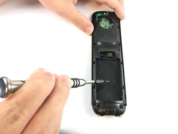

    • Use the Phillips #0 Screwdriver to remove the (2) two 6mm screws.
    • Pull the bottom cover off of the remote control.

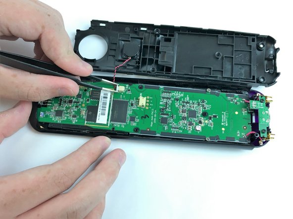

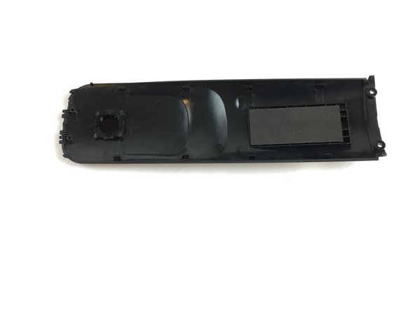

  5. Logitech Harmony 950 Case Replacement, Case: crwdns2935265:05crwdnd2935265:01crwdnd2935265:03crwdne2935265:0 Logitech Harmony 950 Case Replacement, Case: crwdns2935265:05crwdnd2935265:02crwdnd2935265:03crwdne2935265:0 Logitech Harmony 950 Case Replacement, Case: crwdns2935265:05crwdnd2935265:03crwdnd2935265:03crwdne2935265:0
    • Use the Phillips #1 screwdriver to remove the (3) three 6mm screws.
    • Push the opening tool into the gap along the side of the remote, then slide it across until you hear clicking sounds.
    • You need to repeat this process for both sides of the remote.
  6. Logitech Harmony 950 Case Replacement: crwdns2935265:06crwdnd2935265:01crwdnd2935265:03crwdne2935265:0 Logitech Harmony 950 Case Replacement: crwdns2935265:06crwdnd2935265:02crwdnd2935265:03crwdne2935265:0 Logitech Harmony 950 Case Replacement: crwdns2935265:06crwdnd2935265:03crwdnd2935265:03crwdne2935265:0
    $3.99

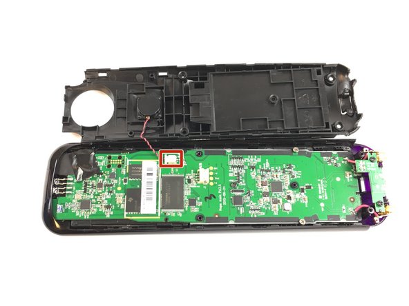

    • Carefully remove the back cover and place it next to the remote. Be careful not to detach the wire during this process.
    • Use the angled Tweezers to carefully pull the white cable end off of the remote and disconnect it.

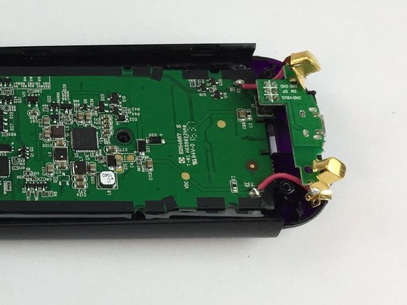

  7. Logitech Harmony 950 Case Replacement: crwdns2935265:07crwdnd2935265:01crwdnd2935265:03crwdne2935265:0 Logitech Harmony 950 Case Replacement: crwdns2935265:07crwdnd2935265:02crwdnd2935265:03crwdne2935265:0 Logitech Harmony 950 Case Replacement: crwdns2935265:07crwdnd2935265:03crwdnd2935265:03crwdne2935265:0
    • Use the Phillips #0 screwdriver to remove the (5) five 6mm screws. Keep in mind that once the screws are off, the circuit board will be completely separate from the case.
    • Be careful not to damage or disconnect the pink wires when removing the gold charging conductors from the case.

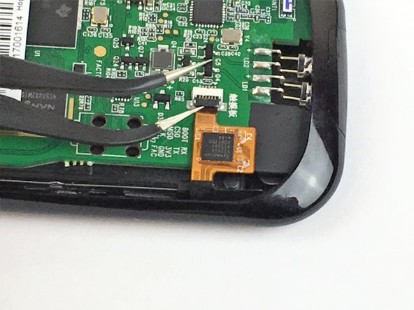

    • Remove the black tape to fully access the cable underneath.
    • This cable has a locking mechanism. Use the Angled Tweezers to lift the black part (lock).
    • Slide the yellow cable to disconnect it from the circuit board.

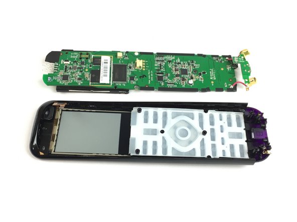

  9. Logitech Harmony 950 Case Replacement: crwdns2935265:09crwdnd2935265:01crwdnd2935265:02crwdne2935265:0 Logitech Harmony 950 Case Replacement: crwdns2935265:09crwdnd2935265:02crwdnd2935265:02crwdne2935265:0
    • Pull the circuit board off of the case. Start from the bottom, and lift up to completely detach it from the cover.
  10. Logitech Harmony 950 Case Replacement: crwdns2935265:010crwdnd2935265:01crwdnd2935265:03crwdne2935265:0 Logitech Harmony 950 Case Replacement: crwdns2935265:010crwdnd2935265:02crwdnd2935265:03crwdne2935265:0 Logitech Harmony 950 Case Replacement: crwdns2935265:010crwdnd2935265:03crwdnd2935265:03crwdne2935265:0
    • Use the Blunt Tweezers to carefully remove the keypad from the cover of the remote.
