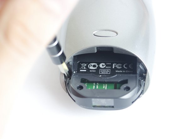

  3. Logitech Harmony 900 Motherboard Replacement, Motherboard: crwdns2935265:03crwdnd2935265:01crwdnd2935265:01crwdne2935265:0
    • Using tweezers, peel off the sticker located under the battery cover to reveal two screws.

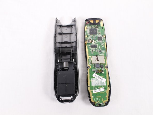

  6. Logitech Harmony 900 Motherboard Replacement: crwdns2935265:06crwdnd2935265:01crwdnd2935265:02crwdne2935265:0 Logitech Harmony 900 Motherboard Replacement: crwdns2935265:06crwdnd2935265:02crwdnd2935265:02crwdne2935265:0
    • Locate the three 50mm screws on the back of the remote and remove them using the Phillips #0 screwdriver.
  7. Logitech Harmony 900 Motherboard Replacement: crwdns2935265:07crwdnd2935265:01crwdnd2935265:02crwdne2935265:0 Logitech Harmony 900 Motherboard Replacement: crwdns2935265:07crwdnd2935265:02crwdnd2935265:02crwdne2935265:0
    • Pry the black, front face of the remote from the back silver part by inserting a credit card in between and sliding down.
    • Again, you may need to use a metal prying tool to get the separation started.

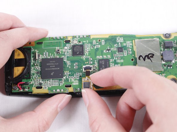

  8. Logitech Harmony 900 Motherboard Replacement: crwdns2935265:08crwdnd2935265:01crwdnd2935265:02crwdne2935265:0 Logitech Harmony 900 Motherboard Replacement: crwdns2935265:08crwdnd2935265:02crwdnd2935265:02crwdne2935265:0
    • When you look at the circuit board, you should see a ribbon attaching the board to the plastic casing.
    • A little lever is holding the ribbon in place. Lift the lever with your nail or a 2.5mm flat-head screwdriver. Move the ribbon away from the circuit board.
  9. Logitech Harmony 900 Motherboard Replacement: crwdns2935265:09crwdnd2935265:01crwdnd2935265:02crwdne2935265:0 Logitech Harmony 900 Motherboard Replacement: crwdns2935265:09crwdnd2935265:02crwdnd2935265:02crwdne2935265:0
    • Using the Philips #0 screwdriver, remove the three 50mm screws from the circuit board.
  10. Logitech Harmony 900 Motherboard Replacement: crwdns2935265:010crwdnd2935265:01crwdnd2935265:01crwdne2935265:0
    • Using your hands, carefully separate the motherboard from the rest of the remote.
