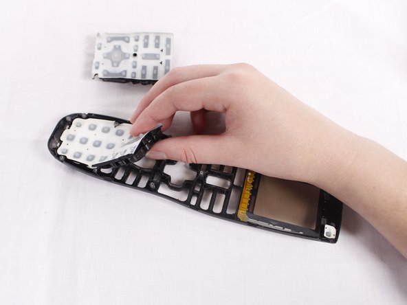

  10. Logitech Harmony 900 Button Pad Replacement: crwdns2935265:010crwdnd2935265:01crwdnd2935265:01crwdne2935265:0
    • Using your hands, carefully separate the motherboard from the rest of the remote.
  11. Logitech Harmony 900 Button Pad Replacement, Button Pad: crwdns2935265:011crwdnd2935265:01crwdnd2935265:02crwdne2935265:0 Logitech Harmony 900 Button Pad Replacement, Button Pad: crwdns2935265:011crwdnd2935265:02crwdnd2935265:02crwdne2935265:0
    • Peel off the button pads from the device frame.
