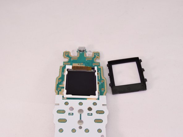

  10. Logitech Harmony 650 Screen Replacement, Screen: crwdns2935265:010crwdnd2935265:01crwdnd2935265:02crwdne2935265:0 Logitech Harmony 650 Screen Replacement, Screen: crwdns2935265:010crwdnd2935265:02crwdnd2935265:02crwdne2935265:0
    • Remove the black rubber gasket that surrounds the screen from the top face of the motherboard.
    • The gasket has 3 tabs along each side. The thick side of the gasket faces the top.
  11. Logitech Harmony 650 Screen Replacement: crwdns2935265:011crwdnd2935265:01crwdnd2935265:01crwdne2935265:0
    • Use a soldering iron to loosen the solder that connects the screen strip to the back of the motherboard. If it does not loosen easily then try using a soldering remover wick.
    • The soldering iron gets extremely hot use caution when using it around components.
  12. Logitech Harmony 650 Screen Replacement: crwdns2935265:012crwdnd2935265:01crwdnd2935265:01crwdne2935265:0
  13. Logitech Harmony 650 Screen Replacement: crwdns2935265:013crwdnd2935265:01crwdnd2935265:01crwdne2935265:0
    • Use a spudger or your hand to remove the screen from the motherboard. It is glued down.
