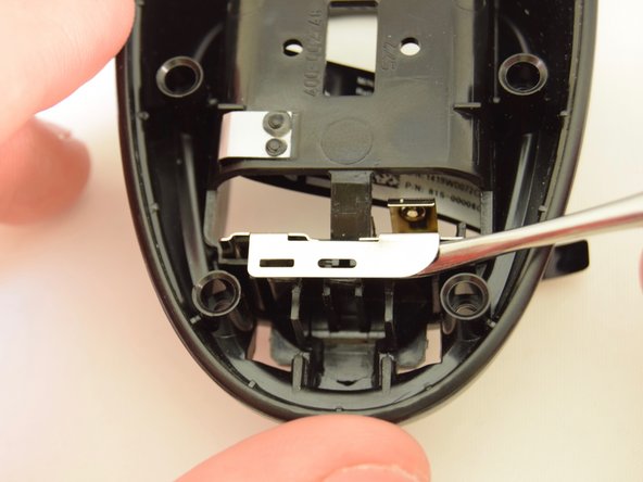

    1. Logitech Harmony 650 Battery Terminal Replacement, Battery Terminal: crwdns2935265:08crwdnd2935265:01crwdnd2935265:02crwdne2935265:0 Logitech Harmony 650 Battery Terminal Replacement, Battery Terminal: crwdns2935265:08crwdnd2935265:02crwdnd2935265:02crwdne2935265:0
      • Using the small end of a spudger, pry out the terminal from the interior of the case.
    2. Logitech Harmony 650 Battery Terminal Replacement: crwdns2935265:09crwdnd2935265:01crwdnd2935265:01crwdne2935265:0
      • Start from one side and work your way to the other side using the spudger.
    3. Logitech Harmony 650 Battery Terminal Replacement: crwdns2935265:010crwdnd2935265:01crwdnd2935265:01crwdne2935265:0
      • Remove the terminal.
