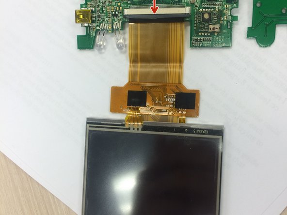

  7. Logitech Harmony 1100 Screen Replacement: crwdns2935265:07crwdnd2935265:01crwdnd2935265:02crwdne2935265:0 Logitech Harmony 1100 Screen Replacement: crwdns2935265:07crwdnd2935265:02crwdnd2935265:02crwdne2935265:0
    • Find the wire that attaches to the screen.
    • Push the dark grey bar that is used to lock the screen in place, outward from the beige bar to disconnect it.
    • Remove the screen wire.
