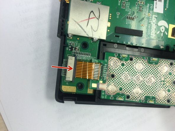

  8. Logitech Harmony 1100 Logic Board Replacement, Logic Board: crwdns2935265:08crwdnd2935265:01crwdnd2935265:02crwdne2935265:0 Logitech Harmony 1100 Logic Board Replacement, Logic Board: crwdns2935265:08crwdnd2935265:02crwdnd2935265:02crwdne2935265:0
    • Push grey bar away from the beige bar
    • Remove button tab wire from logic board

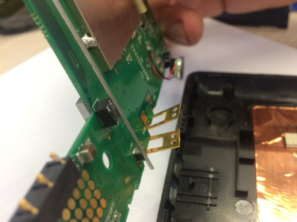

  9. Logitech Harmony 1100 Logic Board Replacement: crwdns2935265:09crwdnd2935265:01crwdnd2935265:03crwdne2935265:0 Logitech Harmony 1100 Logic Board Replacement: crwdns2935265:09crwdnd2935265:02crwdnd2935265:03crwdne2935265:0 Logitech Harmony 1100 Logic Board Replacement: crwdns2935265:09crwdnd2935265:03crwdnd2935265:03crwdne2935265:0
    • Lift on back of gold tab to unsecure positive and negative wires from device
    • Pull the gold buttons in towards the center of the device to detach logic board from case
