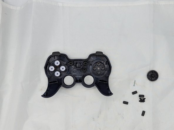

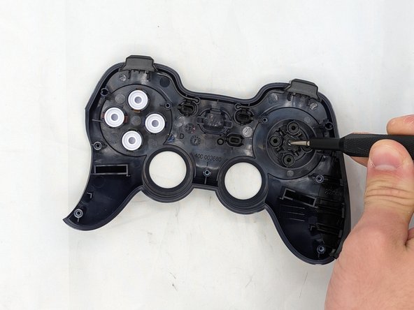

  4. Logitech Gamepad F310 D-Pad Replacement, D-Pad: crwdns2935265:04crwdnd2935265:01crwdnd2935265:03crwdne2935265:0 Logitech Gamepad F310 D-Pad Replacement, D-Pad: crwdns2935265:04crwdnd2935265:02crwdnd2935265:03crwdne2935265:0 Logitech Gamepad F310 D-Pad Replacement, D-Pad: crwdns2935265:04crwdnd2935265:03crwdnd2935265:03crwdne2935265:0
    • Remove the silver 3 mm screw in the middle of the D-pad with a Phillips #1 screwdriver.
    • Remove the D-pad
    • There are 4 buttons that go in the four slots of the D-pad, a spring on one side, and the D-Pad on the other side.
This is how to replace a D-Pad on a Logitech Gamepad F310. To reassemble your device, follow these instructions in reverse order.
