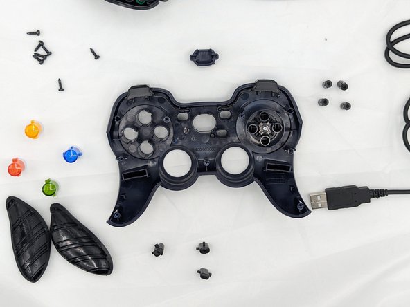

    • Use a Phillips #1 screwdriver to remove all seven 3 mm screws that secure the rear case.
  2. Logitech Gamepad F310 Buttons Replacement: crwdns2935265:02crwdnd2935265:01crwdnd2935265:02crwdne2935265:0 Logitech Gamepad F310 Buttons Replacement: crwdns2935265:02crwdnd2935265:02crwdnd2935265:02crwdne2935265:0
    • Press along the seams of the controller and gently pull the front and rear case apart.
    • If necessary, use an opening tool to help pry the front and rear case apart.
    • Make sure to open the controller with the front facing down so that the buttons do not fall out.
  3. Logitech Gamepad F310 Buttons Replacement: crwdns2935265:03crwdnd2935265:01crwdnd2935265:01crwdne2935265:0
    • Separate the front and rear case.
    • There are two side panels on the controller that come apart as well. When putting them back together, they slot into place on the sides of the controller.
  4. Logitech Gamepad F310 Buttons Replacement, Buttons: crwdns2935265:04crwdnd2935265:01crwdnd2935265:02crwdne2935265:0 Logitech Gamepad F310 Buttons Replacement, Buttons: crwdns2935265:04crwdnd2935265:02crwdnd2935265:02crwdne2935265:0
    • Remove any buttons that need replacement.
    • The buttons sit loosely in the front of the controller, so flipping the front over will drop all of the buttons out.
You're all finished! To reassemble your device, follow these instructions in reverse order.
