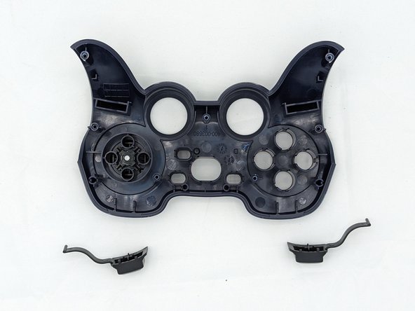

  3. Logitech Gamepad F310 Bumpers Replacement: crwdns2935265:03crwdnd2935265:01crwdnd2935265:01crwdne2935265:0
    • Separate the front and rear case.
    • There are two side panels on the controller that come apart as well. When putting them back together, they slot into place on the sides of the controller.
  4. Logitech Gamepad F310 Bumpers Replacement, Bumpers: crwdns2935265:04crwdnd2935265:01crwdnd2935265:02crwdne2935265:0 Logitech Gamepad F310 Bumpers Replacement, Bumpers: crwdns2935265:04crwdnd2935265:02crwdnd2935265:02crwdne2935265:0
    • Grip the bumper and pull directly up to remove it.
    • Repeat for the other side if necessary.
