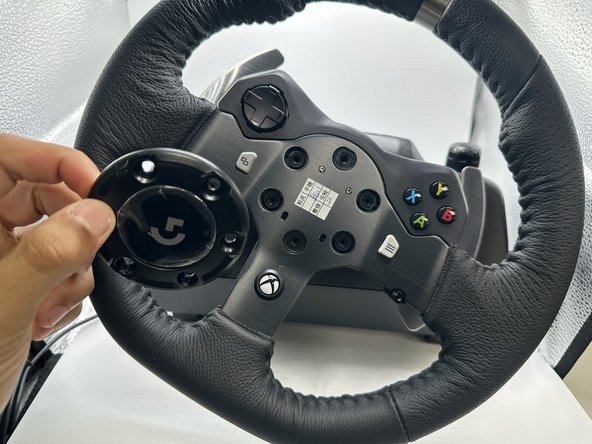

    • Use the Phillips #0 screwdriver to remove the five 9.5 mm external screws.
    • Only three of the five screws are visible from each side of the wheel due to the center unit.

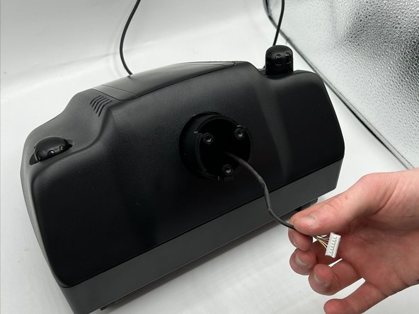

  2. Logitech G920 Driving Force Motor Motherboard Replacement: crwdns2935265:02crwdnd2935265:01crwdnd2935265:01crwdne2935265:0
    • Using the Phillips #0 screwdriver, remove the 5 mm screws holding the bumpers in place.

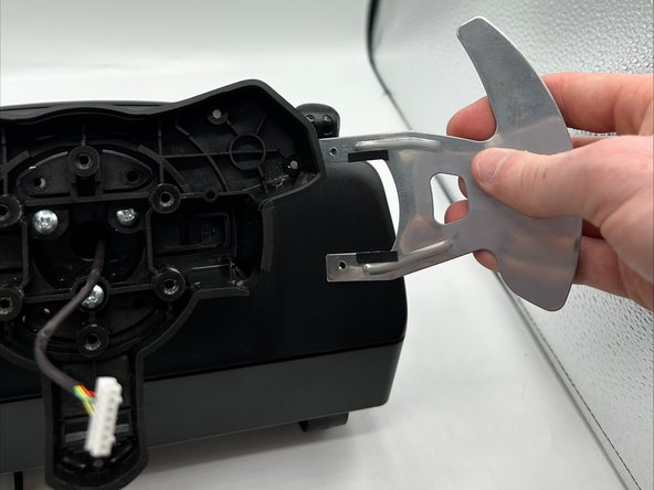

  3. Logitech G920 Driving Force Motor Motherboard Replacement: crwdns2935265:03crwdnd2935265:01crwdnd2935265:02crwdne2935265:0 Logitech G920 Driving Force Motor Motherboard Replacement: crwdns2935265:03crwdnd2935265:02crwdnd2935265:02crwdne2935265:0
    • Using the TR25 Torx Security Screwdriver, remove the six 23.8 mm screws holding the face plate together.
    • Remove the face plate from the steering wheel.

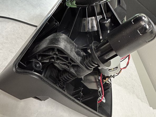

  4. Logitech G920 Driving Force Motor Motherboard Replacement: crwdns2935265:04crwdnd2935265:01crwdnd2935265:02crwdne2935265:0 Logitech G920 Driving Force Motor Motherboard Replacement: crwdns2935265:04crwdnd2935265:02crwdnd2935265:02crwdne2935265:0
    • Remove the wheel from the main steering wheel console.
    • Ensure this is done carefully as to not damage the connection wire.

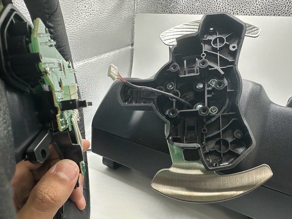

  5. Logitech G920 Driving Force Motor Motherboard Replacement: crwdns2935265:05crwdnd2935265:01crwdnd2935265:02crwdne2935265:0 Logitech G920 Driving Force Motor Motherboard Replacement: crwdns2935265:05crwdnd2935265:02crwdnd2935265:02crwdne2935265:0
    • Remove the four 13.5 mm screws with a Phillips #0 screwdriver.

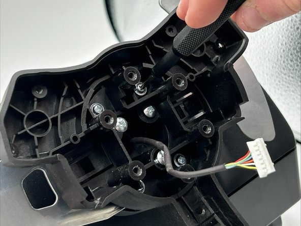

  6. Logitech G920 Driving Force Motor Motherboard Replacement: crwdns2935265:06crwdnd2935265:01crwdnd2935265:02crwdne2935265:0 Logitech G920 Driving Force Motor Motherboard Replacement: crwdns2935265:06crwdnd2935265:02crwdnd2935265:02crwdne2935265:0
    • Remove the pedals from both sides of the wheel base.
