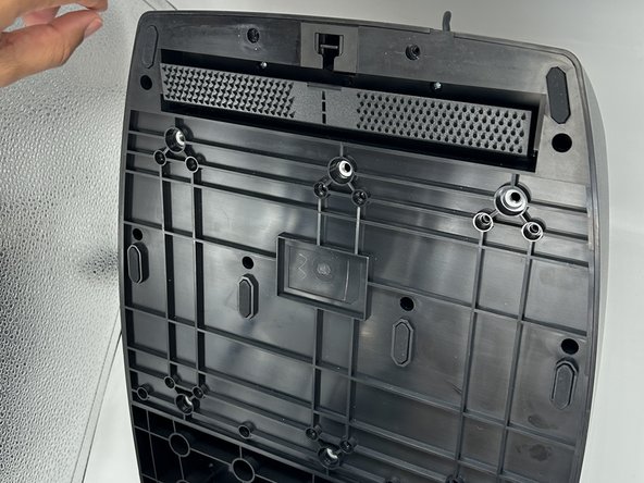

    • Remove the 12 12mm screws from the bottom of the device using a Phillips #1 screwdriver.
  5. Logitech G920 Driving Force Back Pedals Replacement: crwdns2935265:05crwdnd2935265:01crwdnd2935265:01crwdne2935265:0
    • Remove the eight 12 mm screws from the bottom of the device with a Phillips #0 screwdriver.
  6. Logitech G920 Driving Force Back Pedals Replacement: crwdns2935265:06crwdnd2935265:01crwdnd2935265:03crwdne2935265:0 Logitech G920 Driving Force Back Pedals Replacement: crwdns2935265:06crwdnd2935265:02crwdnd2935265:03crwdne2935265:0 Logitech G920 Driving Force Back Pedals Replacement: crwdns2935265:06crwdnd2935265:03crwdnd2935265:03crwdne2935265:0
    • Push down the switch found in the hole at the top of the underside of the pedal board.
    • This opens the carpet-hold to access more screws.

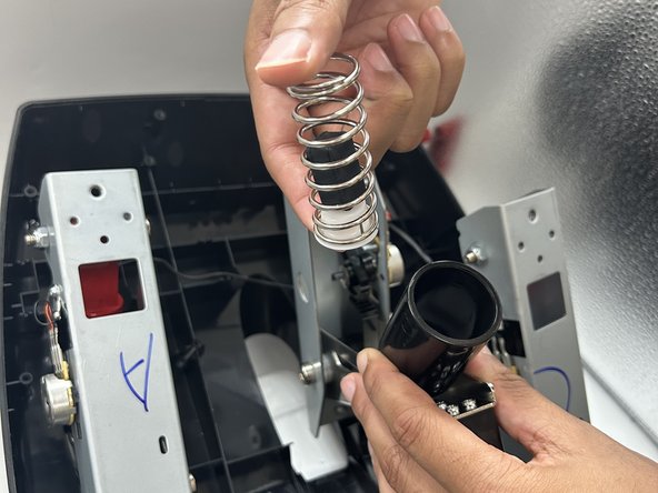

    • Remove the washer and bolt at the top of the red piece on the pedal back.
  10. Logitech G920 Driving Force Back Pedals Replacement: crwdns2935265:010crwdnd2935265:01crwdnd2935265:03crwdne2935265:0 Logitech G920 Driving Force Back Pedals Replacement: crwdns2935265:010crwdnd2935265:02crwdnd2935265:03crwdne2935265:0 Logitech G920 Driving Force Back Pedals Replacement: crwdns2935265:010crwdnd2935265:03crwdnd2935265:03crwdne2935265:0
    • Remove the red piece, spring, and block within the pedal back.
    • Replace the necessary part.
