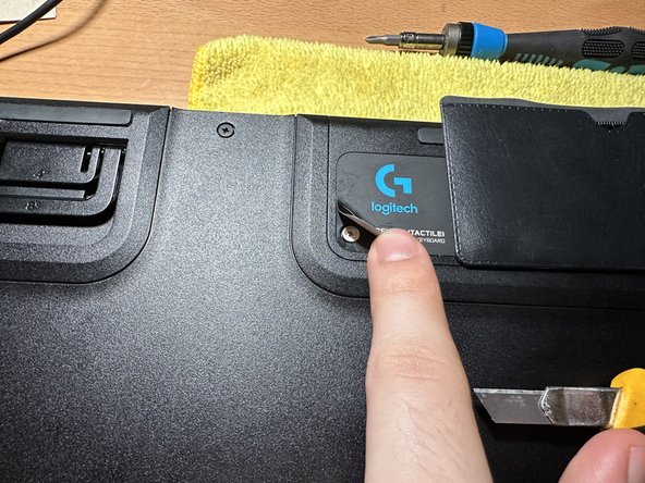

  4. Logitech G915 Wireless: Key switch repair/replacement, Removing Screws Under Label: crwdns2935265:04crwdnd2935265:01crwdnd2935265:02crwdne2935265:0 Logitech G915 Wireless: Key switch repair/replacement, Removing Screws Under Label: crwdns2935265:04crwdnd2935265:02crwdnd2935265:02crwdne2935265:0
    • Using this same technique, heat the corners of the rear sticker (green set) and starting from the corner use the knife to get under the edge while not to crease or fold the sticker too much. Remove the two screws (green set) from under the label.

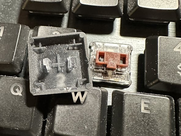

    • Now you need to find the key you want to replace (Which in my case was the number 3 key).
    • Locate the correct key and their corresponding contacts. Using the soldering iron, heat up the solder and remove it using a desoldering pump.
    • Once both contacts have their solder removed, you can flip the keyboard around and remove the key switch from the front of the keyboard.
  7. Logitech G915 Wireless: Key switch repair/replacement: crwdns2935265:07crwdnd2935265:01crwdnd2935265:03crwdne2935265:0 Logitech G915 Wireless: Key switch repair/replacement: crwdns2935265:07crwdnd2935265:02crwdnd2935265:03crwdne2935265:0 Logitech G915 Wireless: Key switch repair/replacement: crwdns2935265:07crwdnd2935265:03crwdnd2935265:03crwdne2935265:0
    • Now if you're replacing a switch you need a new one. Or you can disassemble and clean/re-lubricate the switch.
    • Or in my case you can disassemble the switch by releasing the 2 tabs on each side (purple set). Retrieve the broken keycap piece from inside and reassemble the switch.
    • Now with the switch ready to be soldered back onto the board you can take your solder, flux and soldering iron, insert the switch back through the front of the keyboard and re-solder the two contacts to the board.

The clear plastic actually broke as I noticed my Y key was lopsided at first, so I took the key cover off, low and behold, the clear plastic tabs on one side had given away. I purchased replaced key mechanisms, and disassembled one key, to maybe just replacing the clear piece, while the case was still in tact, no taking it all apart. So far I've not been able to just place that new plastic piece over with the brown piece, and spring in their places, but it doesn't seem to "snap" into place, and I don't want to break this piece.
Any suggestions? Will I have to take the whole assembly apart? Will I have to desolder and add the whole new key?
