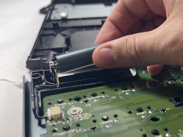

    • Turn the keyboard around and peel back the Logitech sticker near the top center of the keyboard, as well as the plastic layer underneath.
    • Unscrew the two 2.5 mm #0 Phillips screws circled in the picture provided.
    • Remove the backplate by grabbing the notch to the right and pulling up.
  2. Logitech G915 TKL Volume Wheel Replacement: crwdns2935265:02crwdnd2935265:01crwdnd2935265:02crwdne2935265:0 Logitech G915 TKL Volume Wheel Replacement: crwdns2935265:02crwdnd2935265:02crwdnd2935265:02crwdne2935265:0
    • Remove the foam strips shown in the picture provided.
    • Unscrew all the 2 mm #00 Phillips screws on the back of the keyboard circled in the picture provided.
  3. Logitech G915 TKL Volume Wheel Replacement: crwdns2935265:03crwdnd2935265:01crwdnd2935265:01crwdne2935265:0
    • Remove the keyboard's casing to reveal the motherboard.
  4. Logitech G915 TKL Volume Wheel Replacement: crwdns2935265:04crwdnd2935265:01crwdnd2935265:02crwdne2935265:0 Logitech G915 TKL Volume Wheel Replacement: crwdns2935265:04crwdnd2935265:02crwdnd2935265:02crwdne2935265:0
    • Carefully remove the volume wheel from the device using your fingers.
