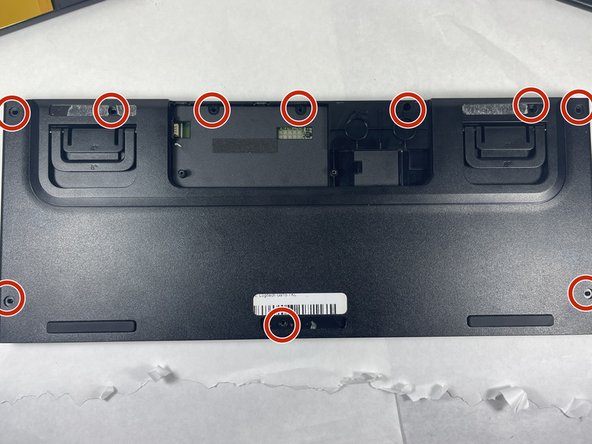

    • Remove all of the keycaps on the keyboard.
    • Unscrew the 2mm #00 Phillips screws circled in the picture provided.
  2. Logitech G915 TKL Keyswitch Replacement: crwdns2935265:02crwdnd2935265:01crwdnd2935265:02crwdne2935265:0 Logitech G915 TKL Keyswitch Replacement: crwdns2935265:02crwdnd2935265:02crwdnd2935265:02crwdne2935265:0
    • Turn the keyboard around and peel back the Logitech sticker near the top center of the keyboard, as well as the plastic layer underneath.
    • Unscrew the two 2.5mm #0 Phillips screws circled in the picture provided.
    • Remove the backplate by grabbing the notch to the right and pulling up.
  3. Logitech G915 TKL Keyswitch Replacement: crwdns2935265:03crwdnd2935265:01crwdnd2935265:02crwdne2935265:0 Logitech G915 TKL Keyswitch Replacement: crwdns2935265:03crwdnd2935265:02crwdnd2935265:02crwdne2935265:0
    • Remove the foam strips shown in the picture provided.
    • Unscrew all the 2mm #00 Phillips screws on the back of the keyboard circled in the picture provided.
  4. Logitech G915 TKL Keyswitch Replacement: crwdns2935265:04crwdnd2935265:01crwdnd2935265:01crwdne2935265:0
    • Remove the casing on the keyboard to reveal the motherboard.
  5. Logitech G915 TKL Keyswitch Replacement: crwdns2935265:05crwdnd2935265:01crwdnd2935265:01crwdne2935265:0
    • Find the corresponding soldering point for the keyswitch you wish to replace.
  6. Logitech G915 TKL Keyswitch Replacement: crwdns2935265:06crwdnd2935265:01crwdnd2935265:01crwdne2935265:0
    • Carefully heat the soldering wire.
    • Place the wire near the keyswitch's solder points so that it can be desoldered by the wire.
    • Insert your new keyswitch in place of the old one.
    • Solder the new keyswitch into place.
