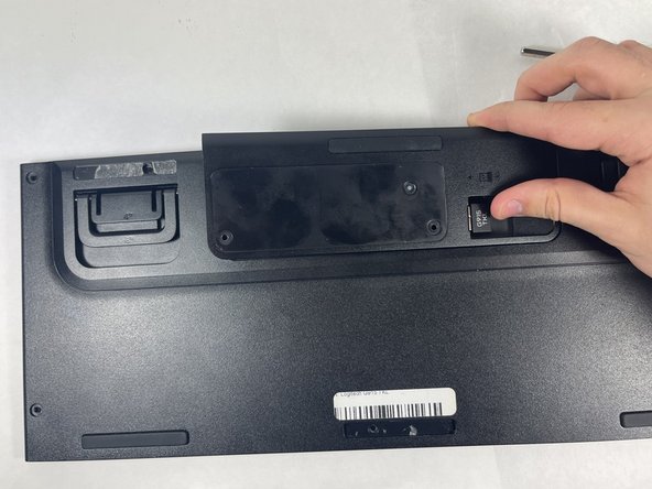

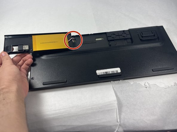

  3. Logitech G915 TKL G1-G8 Key Replacement, Take out the battery: crwdns2935265:03crwdnd2935265:01crwdnd2935265:03crwdne2935265:0 Logitech G915 TKL G1-G8 Key Replacement, Take out the battery: crwdns2935265:03crwdnd2935265:02crwdnd2935265:03crwdne2935265:0 Logitech G915 TKL G1-G8 Key Replacement, Take out the battery: crwdns2935265:03crwdnd2935265:03crwdnd2935265:03crwdne2935265:0
    • Remove the battery.
    • This will require the removal of the back sticker and unscrewing the two 2.5mm #0 Phillips screws circled.
