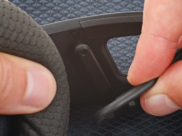

  1. Logitech G733 Wireless Headset Headband Strap Replacement, Remove the headband strap: crwdns2935265:01crwdnd2935265:01crwdnd2935265:03crwdne2935265:0 Logitech G733 Wireless Headset Headband Strap Replacement, Remove the headband strap: crwdns2935265:01crwdnd2935265:02crwdnd2935265:03crwdne2935265:0 Logitech G733 Wireless Headset Headband Strap Replacement, Remove the headband strap: crwdns2935265:01crwdnd2935265:03crwdnd2935265:03crwdne2935265:0
    • Grip your headset with one hand, and use your free hand to firmly pull the headband strap buckle off its post.
    • Repeat the process on the other buckle.

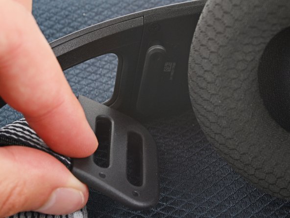

  2. Logitech G733 Wireless Headset Headband Strap Replacement: crwdns2935265:02crwdnd2935265:01crwdnd2935265:01crwdne2935265:0
    • Remove the headband strap.
    • To reinstall the strap, firmly push each buckle over its post until it slides into place.
    • If you're adjusting the strap, the lower cutouts will loosen the fit and the upper ones will tighten it.
