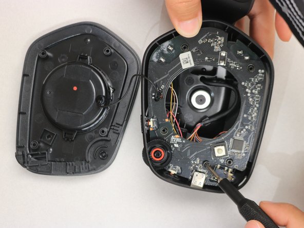

  3. Logitech G733 Power Button Replacement: crwdns2935265:03crwdnd2935265:01crwdnd2935265:03crwdne2935265:0 Logitech G733 Power Button Replacement: crwdns2935265:03crwdnd2935265:02crwdnd2935265:03crwdne2935265:0 Logitech G733 Power Button Replacement: crwdns2935265:03crwdnd2935265:03crwdnd2935265:03crwdne2935265:0
    • Gently lift off the speaker housing, with care not to strain the connected cable.
    • Remove the screw on the bottom right-hand side of the motherboard using a Phillips #000 screwdriver.
    • Use your thumb to gently pull back the tab at the upper right-hand corner of the headphone and simultaneously pull the circuit board out.
    • The scroll wheel may fly out when you pop the circuit board out.

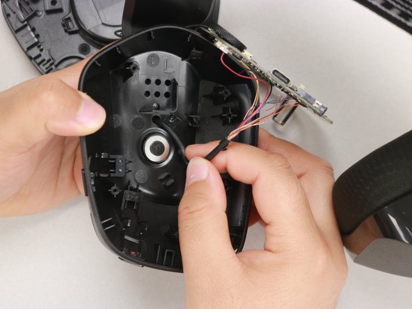

  4. Logitech G733 Power Button Replacement: crwdns2935265:04crwdnd2935265:01crwdnd2935265:02crwdne2935265:0 Logitech G733 Power Button Replacement: crwdns2935265:04crwdnd2935265:02crwdnd2935265:02crwdne2935265:0
    • Once the motherboard is loose, gently pull the wire out of its harness.
    • The wiring harness is glued, so be careful with it. It should pull out easily.
