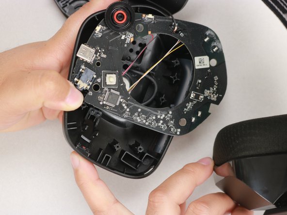

  3. Logitech G733 Charging Port Replacement: crwdns2935265:03crwdnd2935265:01crwdnd2935265:03crwdne2935265:0 Logitech G733 Charging Port Replacement: crwdns2935265:03crwdnd2935265:02crwdnd2935265:03crwdne2935265:0 Logitech G733 Charging Port Replacement: crwdns2935265:03crwdnd2935265:03crwdnd2935265:03crwdne2935265:0
    • Remove the screw on the bottom right-hand side of the headphone using a Phillips #00 screwdriver.
    • Use your thumb to gently pull back the tab at the upper right-hand corner of the headphone and simultaneously pull the motherboard out.
    • The scroll wheel may fly out when you pop the circuit board out. If so, just put it back in by lining up the two flat surfaces of the connectors.

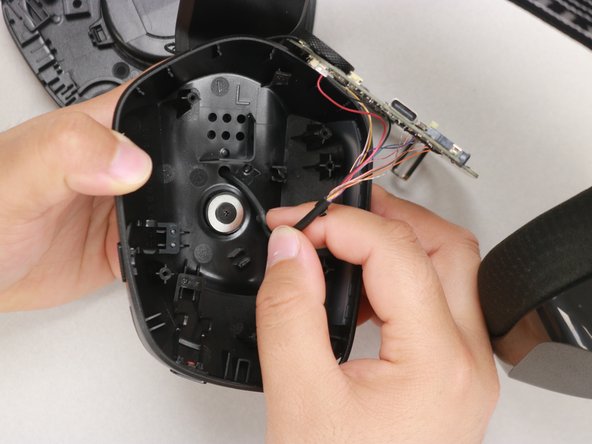

  4. Logitech G733 Charging Port Replacement: crwdns2935265:04crwdnd2935265:01crwdnd2935265:02crwdne2935265:0 Logitech G733 Charging Port Replacement: crwdns2935265:04crwdnd2935265:02crwdnd2935265:02crwdne2935265:0
    • Once the motherboard is loose, pull the wire out of its harness.
    • The wiring harness is glued, so be careful with it. It should pull out easily.

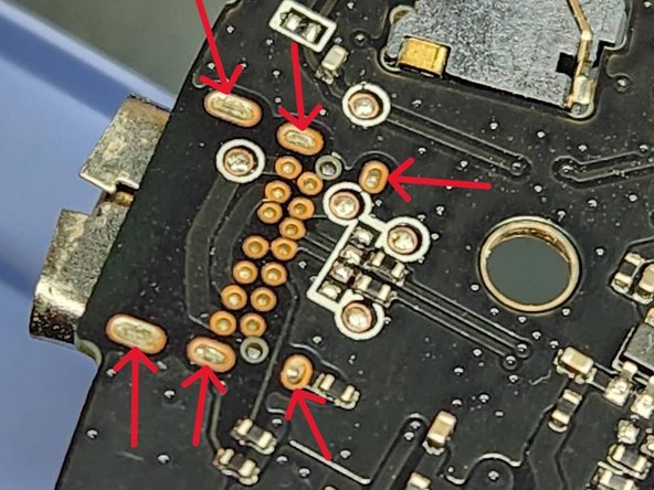

  5. Logitech G733 Charging Port Replacement: crwdns2935265:05crwdnd2935265:01crwdnd2935265:03crwdne2935265:0 Logitech G733 Charging Port Replacement: crwdns2935265:05crwdnd2935265:02crwdnd2935265:03crwdne2935265:0 Logitech G733 Charging Port Replacement: crwdns2935265:05crwdnd2935265:03crwdnd2935265:03crwdne2935265:0
    • Using the soldering iron, apply heat to three pins on one side and wiggle the port free from the melted pool of solder.
    • Repeat for the opposite side.
    • This step takes a lot of skill. Be careful not to melt the circuit board with the soldering iron, and always solder in a well-ventilated area.
