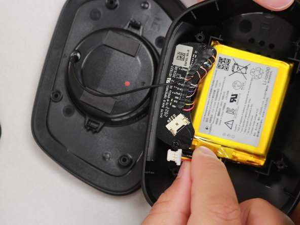

      • Lift off the speaker housing with care not to strain the connected cable.
      • Gently wiggle the white battery cable connector side to side while pulling it out to disconnect the battery.
      • Do not pull on the wires.
    4. Logitech G733 Battery Replacement: crwdns2935265:04crwdnd2935265:01crwdnd2935265:01crwdne2935265:0
      • Take care not to puncture, twist, or bend the battery as you pry.
      • Remove the battery, using a spudger to gently pry it up if necessary.
      • Reapply adhesive, put the new battery in place, and plug it in.

Its a 1.5 phillips on the right side. On the left side its a T5 screw not a T4. And you can easily remove the battery without a spudger. It came out with my bare hands.
