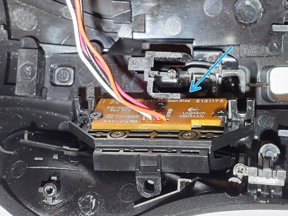

      • To remove the side button assembly:
      • First, unhook the cables from the cable guide so it won't get caught while popping the assembly out
      • The assembly is held in by some clip-in action from the screw posts on the top shell and screw holes on the assembly. The next step will explain in detail how to pop it out.
      • Definitely don't pull on the cable to remove like shown in the first picture. The wires are kind of frail.

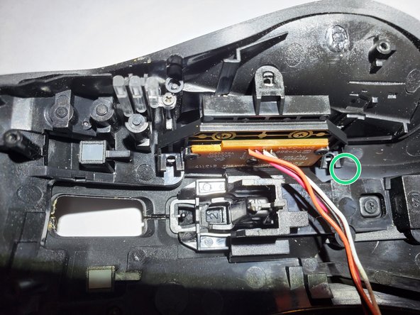

    3. Logitech G700s Side Button Array Replacement: crwdns2935265:06crwdnd2935265:01crwdnd2935265:03crwdne2935265:0 Logitech G700s Side Button Array Replacement: crwdns2935265:06crwdnd2935265:02crwdnd2935265:03crwdne2935265:0 Logitech G700s Side Button Array Replacement: crwdns2935265:06crwdnd2935265:03crwdnd2935265:03crwdne2935265:0
      • The screw hole near the left and button side seems to be easier to pop out first. Use thumbnail to pry under the marked location while simultaneously pushing on G7 to pop it out.
      • Repeat on the other side, pressing on G8.
      • The assembly should come loose. Push on the buttons and gently wiggle and pull it out.
      • There will still be a bit of friction between the PCB and the center post on the top shell but it won't take too much force. Try to gently persuade it out.
