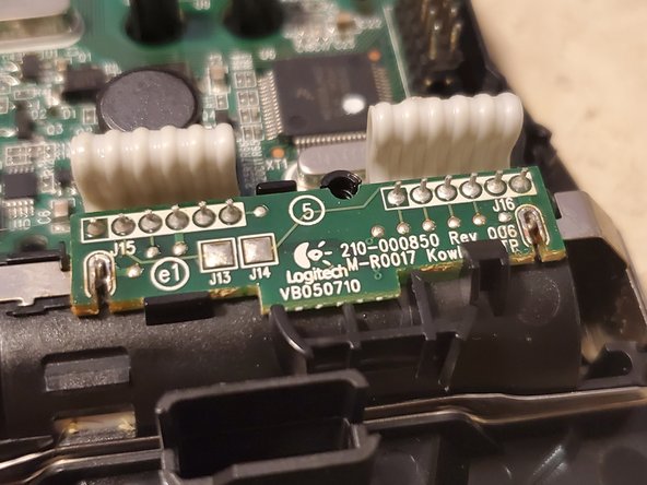

  6. Logitech G700s Bottom PCB Assembly Replacement, Top button PCB assembly: crwdns2935265:06crwdnd2935265:01crwdnd2935265:03crwdne2935265:0 Logitech G700s Bottom PCB Assembly Replacement, Top button PCB assembly: crwdns2935265:06crwdnd2935265:02crwdnd2935265:03crwdne2935265:0 Logitech G700s Bottom PCB Assembly Replacement, Top button PCB assembly: crwdns2935265:06crwdnd2935265:03crwdnd2935265:03crwdne2935265:0
    Desoldering Pump
    $3.99
    • Desolder the header pins. Desolder while the screws and mounting hardware in the next two steps are still attached, so the board is more stable.
    • Pay attention to the plastic parts near the header. Find a comfortable position where your iron isn't likely to come into contact with the plastic parts, as they will melt if the iron comes into contact with them.
    • Use plenty of flux. I find engineer SS-02 solder sucker to be much less frustrating to use, since its cylinder has O-ring seals and pulls a good suction. It also has a flexible heat resistant tip that allows you to press it against the PCB and the iron.
    • Look straight down and check that there most of the solder between the pin and the sidewall is removed. Push each pin sideways to make sure it is detached.
    • If there are still significant amount of solder, reheat the joint and try sucking again.
    • If it looks mostly clear but the pin is still attached, try pushing the pin to the opposite wall (where it is clearly detached) with a moderate amount of force. (Do not force it too much though or you risk damaging the through hole plating)
    • If it doesn't budge with a moderate amount of force, try using the iron to push on the pin the same way. If it attaches to another part, then the solder isn't sucked up enough.
    • Optionally, you may want to mod the PCB to use a socket to connect between the top and bottom, so it will be easier to access in the future. You will need to replace or cut short the header pins. It uses 2.0mm pitch 2x7 headers. There is approximately 7.2mm between the boards. I used Molex 87758-1450 pins and Amphenol 63453-114LF socket.

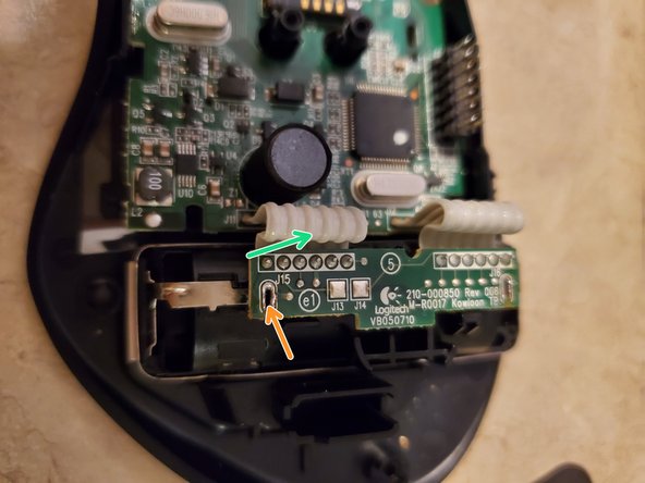

  9. Logitech G700s Bottom PCB Assembly Replacement, Battery terminal and debug header daughterboard: crwdns2935265:09crwdnd2935265:01crwdnd2935265:02crwdne2935265:0 Logitech G700s Bottom PCB Assembly Replacement, Battery terminal and debug header daughterboard: crwdns2935265:09crwdnd2935265:02crwdnd2935265:02crwdne2935265:0
    • Desolder the battery terminal connections.
    • The battery terminals are individually removable, so you may try to pull the board out with the terminals. Though it might be difficult to remove the terminals at an angle.
    • If you do choose to do this, be sure to grab it by the end of battery terminals (indicated by yellow arrows) rather than the board to avoid bending the terminals unnecessarily.
    • Remove the philips head screw securing the daughterboard.

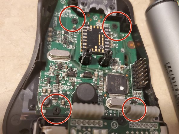

  10. Logitech G700s Bottom PCB Assembly Replacement: crwdns2935265:010crwdnd2935265:01crwdnd2935265:03crwdne2935265:0 Logitech G700s Bottom PCB Assembly Replacement: crwdns2935265:010crwdnd2935265:02crwdnd2935265:03crwdne2935265:0 Logitech G700s Bottom PCB Assembly Replacement: crwdns2935265:010crwdnd2935265:03crwdnd2935265:03crwdne2935265:0
    • Remove the clear plastic piece by alternatingly prying on the two ends of it little by little.
    • Remove the 4 philips head screws securing the bottom PCB assembly to the bottom case.
    • Remove the bottom PCB assembly together with the daughterboard. If solder is still catching, try making at least one terminal free, then heat the remaining terminal and simultaneusly pull it free.
