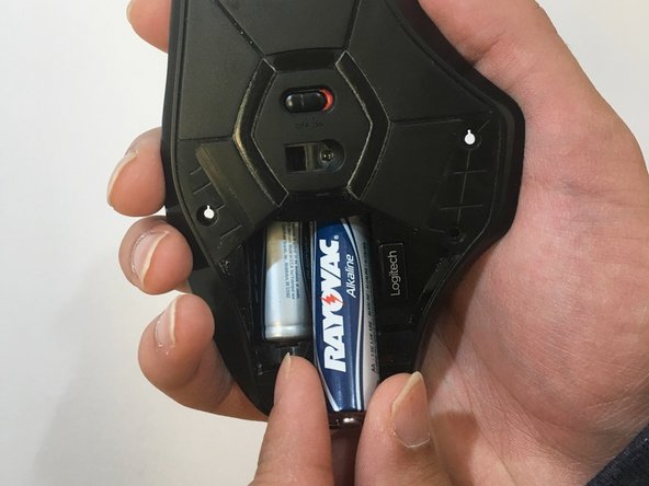

    • Use the blue spudger to prop open the bottom battery port.
    • Remove the AA batteries.
