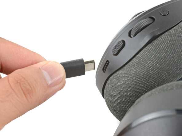

  1. Logitech G522/A20 X Lightspeed Ear Pads Replacement, Prepare the headset for disassembly: crwdns2935265:01crwdnd2935265:01crwdnd2935265:02crwdne2935265:0 Logitech G522/A20 X Lightspeed Ear Pads Replacement, Prepare the headset for disassembly: crwdns2935265:01crwdnd2935265:02crwdnd2935265:02crwdne2935265:0
    • Power off the headset and unplug all cables.

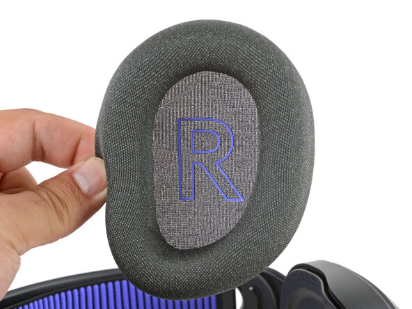

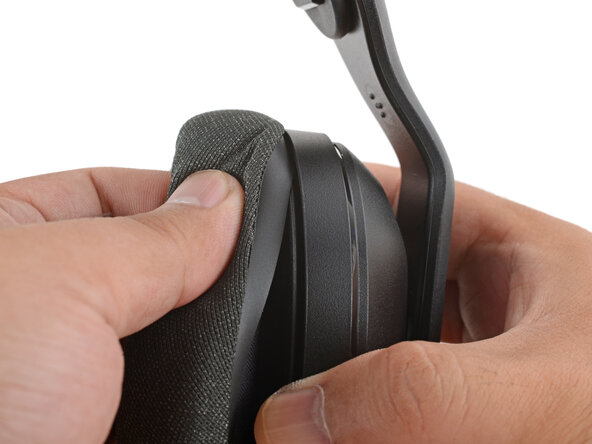

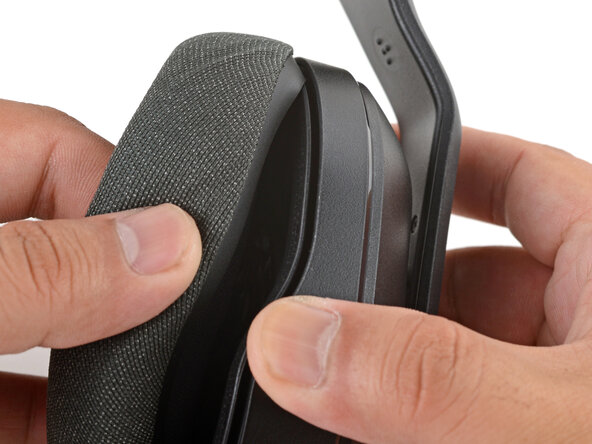

  2. Logitech G522/A20 X Lightspeed Ear Pads Replacement, Remove the ear pads: crwdns2935265:02crwdnd2935265:01crwdnd2935265:03crwdne2935265:0 Logitech G522/A20 X Lightspeed Ear Pads Replacement, Remove the ear pads: crwdns2935265:02crwdnd2935265:02crwdnd2935265:03crwdne2935265:0 Logitech G522/A20 X Lightspeed Ear Pads Replacement, Remove the ear pads: crwdns2935265:02crwdnd2935265:03crwdnd2935265:03crwdne2935265:0
    • With one hand, firmly hold an ear cup steady.
    • With your free hand, slowly pull the ear pad away from the cup until it slides completely off its plastic lip.
    • Repeat the process to remove the other ear pad.

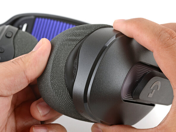

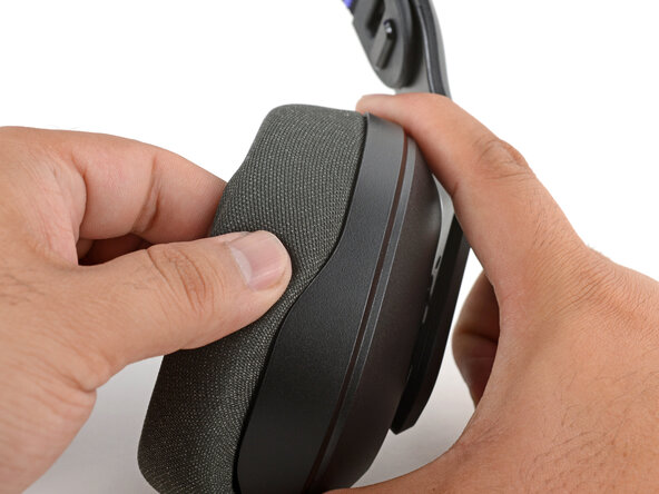

  3. Logitech G522/A20 X Lightspeed Ear Pads Replacement, Install an ear pad: crwdns2935265:03crwdnd2935265:01crwdnd2935265:03crwdne2935265:0 Logitech G522/A20 X Lightspeed Ear Pads Replacement, Install an ear pad: crwdns2935265:03crwdnd2935265:02crwdnd2935265:03crwdne2935265:0 Logitech G522/A20 X Lightspeed Ear Pads Replacement, Install an ear pad: crwdns2935265:03crwdnd2935265:03crwdnd2935265:03crwdne2935265:0
    • Installing an ear pad onto the cup can be tricky. Be patient and work slowly—it may take a couple tries.
    • To put an ear pad onto its cup:
    • With your free hand, place the pad over the top of the cup, so the fabric flap slips over the cup's plastic lip.
    • Thread the rest of the flap over the lip, working your way around the entire cup. Gently stretch the pad as necessary.
    • Check the entire perimeter of the cup to make sure the ear pad is fully on. If any of the fabric flap is sticking out, try to push it over the lip or remove the ear pad and try again.
