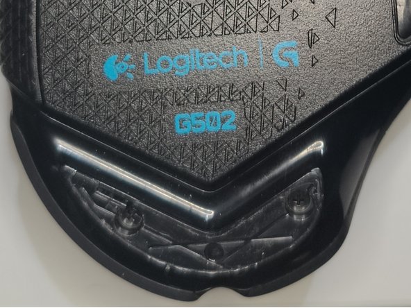

    • Use a hairdryer to heat three mouse feet briefly.
    • Each mouse foot should take 7-8 seconds to heat up.

Let's say you're trying to fix your G502 without a legit logitech cord, you can just splice a usb cable and solder the correct wires to the pins. I did this twice and it works flawlessly
